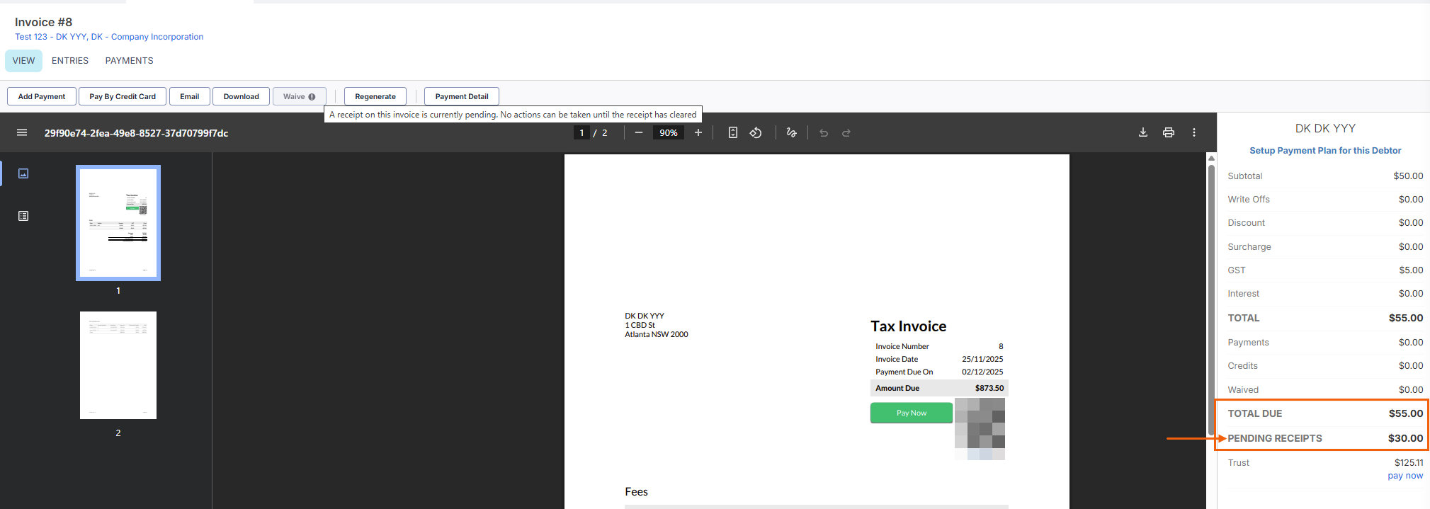

The pending payment also appears under the invoice's payments tab:

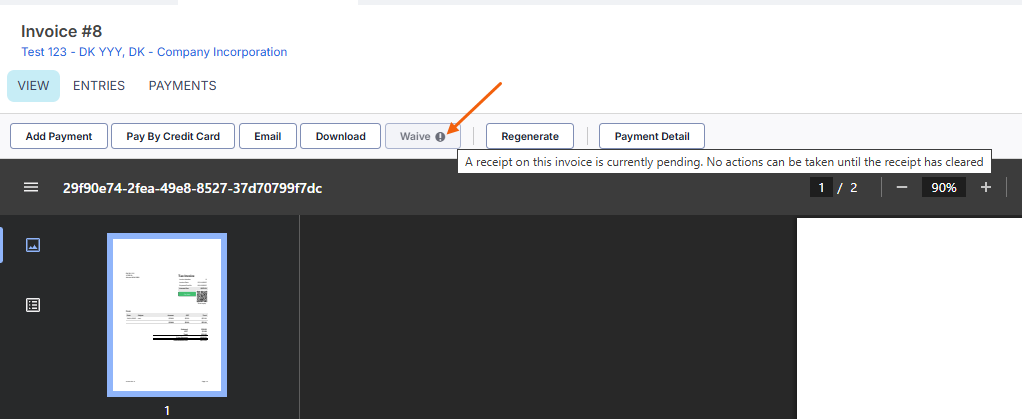

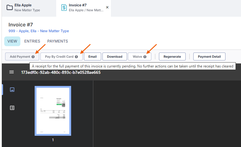

When there is a pending payment for the full amount of the invoice (i.e. it is within its clearance days period), the Add Payment, Pay By Credit Card and Waive buttons will be disabled.
When there is a pending payment for a partial amount of the invoice, only the Waive button will be disabled, and the debtor can only pay the remaining balance of the invoice.
