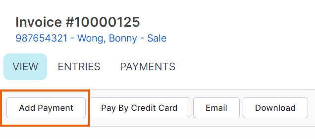

  2. Select the Invoices tab and click on the relevant invoice.
  3. Select Add Payment.

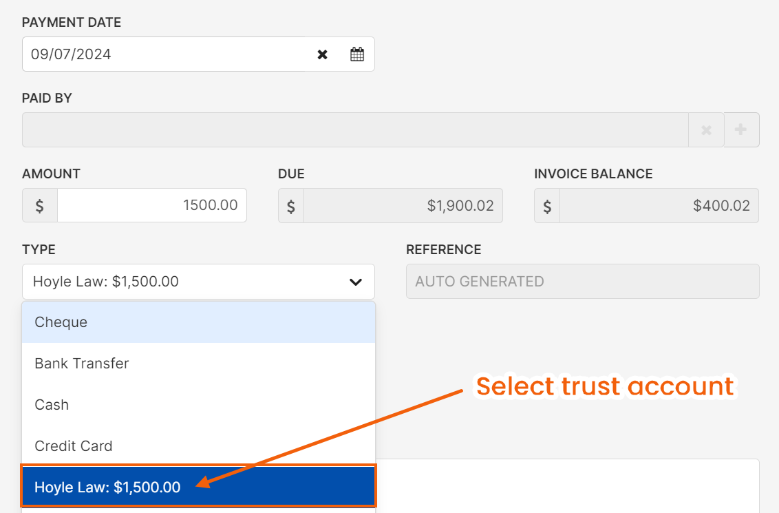

  4. Enter the Payment Date, which is the date the payment was processed as shown on your Trust Bank Account statement.
  5. Under the Type drop-down menu, select your trust account.
  6. In the Reason field, enter "Trust to Office Transfer" or similar.
  7. Ensure the rest of the payment details are correctly entered, then select Process.

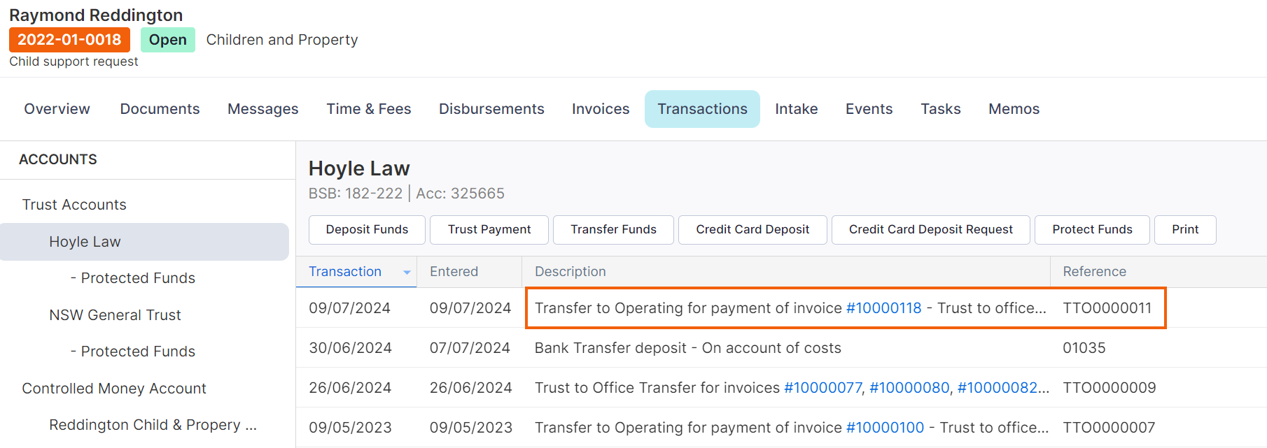

The trust to office transfer will now appear under the Transactions tab of the matter, with the description denoting that it is a trust to office transfer.
