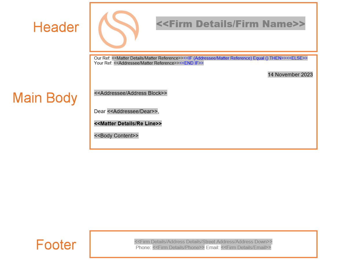

Letter, No Footer document container structure
The Letter, No Footer document container has the same structure as the Letter document container, but it does not include a sign off.
A Letter, No Footer document container is specifically used with precedents that will have additional text after the sign-off of the letter.

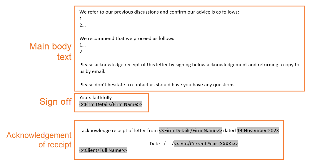

In this example, we want to add an acknowledgement of receipt of the letter after the letter's sign off.
Step 1 - Create the precedent
First, we begin with setting up the precedent. When you create your precedent, in modify mode, you will set up the following:
  1. the main body of the letter;
  2. the sign off, with its text and any relevant automation fields; then
  3. follow with the acknowledgement of receipt text and any automation fields.

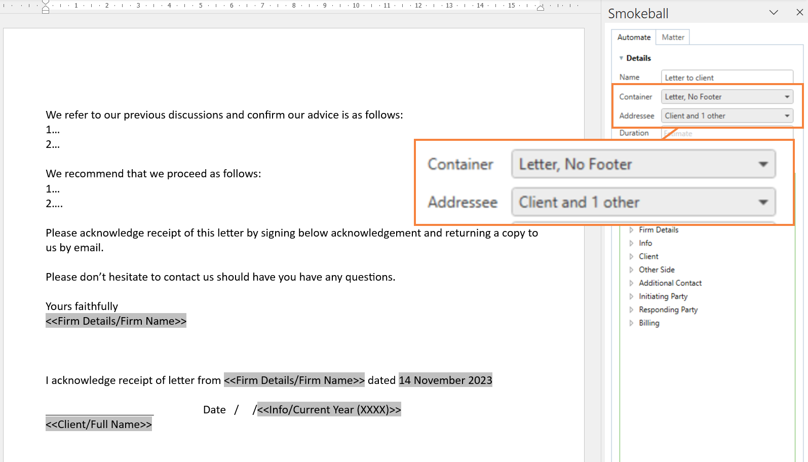

Step 2 - Link the precedent to the document container
Next, you can link the precedent to the Letter, No Footer document container by selecting it from the drop-down menu, and then select the Addressee for the precedent. Save and Close the precedent.

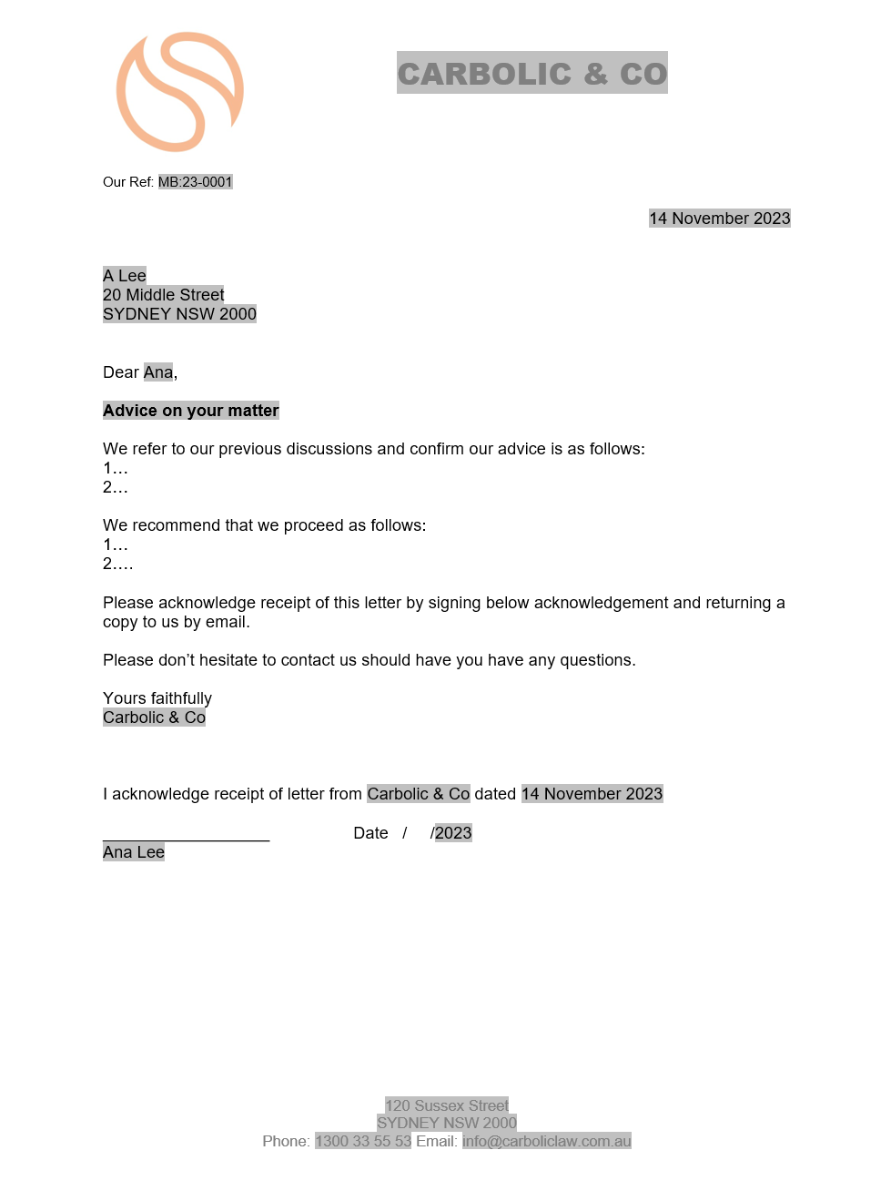

Step 3 - Test the precedent
Test out your precedent by generating it from your matter. It will now show your document container applied to your precedent in the one document:
