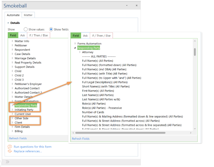

This article walks through some common fields that are used. If you are creating a template that you want to use across a variety of matter types, be sure to use generic terms like "Client/"Other side" or "Initiating Party/Responding Party."
Common fields for automation
Initiating Party/Responding Party and Client/Other Side
  • Use the generic terms to simplify the template and allow any template to be used across multiple Matter Types

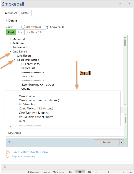

  • Select the triangle icon to see more details. The best practice is to close any triangle icon to make scrolling through the TemplateLab toolbar easier.
Case number and Court details

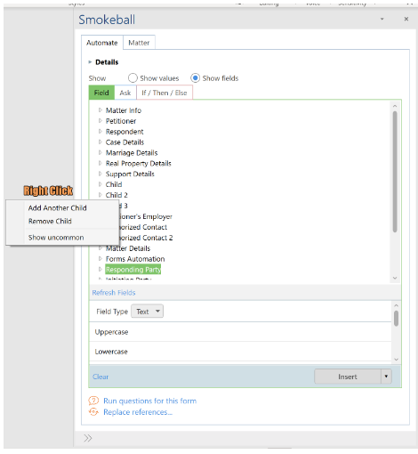

Right-click to add additional field options for multiple parties listed on the matter.

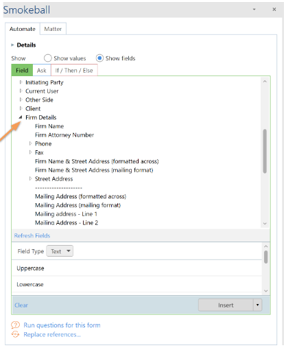

Firm Details
