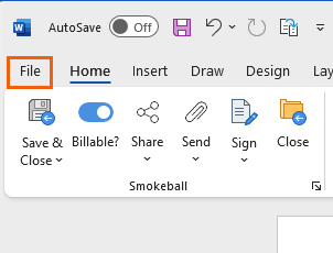

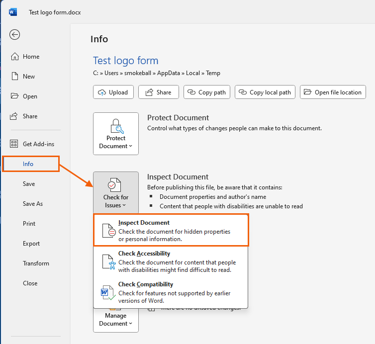

  1. While in Word, select File.
  2. Select Info from the list of actions located on the left side of your screen.
  3. Select the button to Check for Issues.
  4. Select Inspect Document.

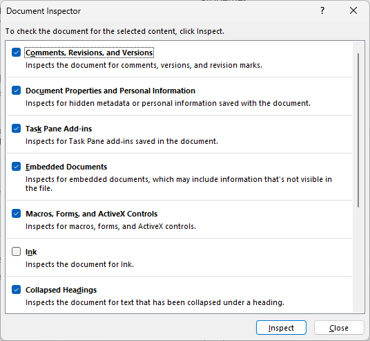

  5. Select the checkboxes you wish the tool to review in the pop-up window and then select the Inspect button.
  6. If any issues are flagged, select the Remove All button to remove them.
  7. Select Close.

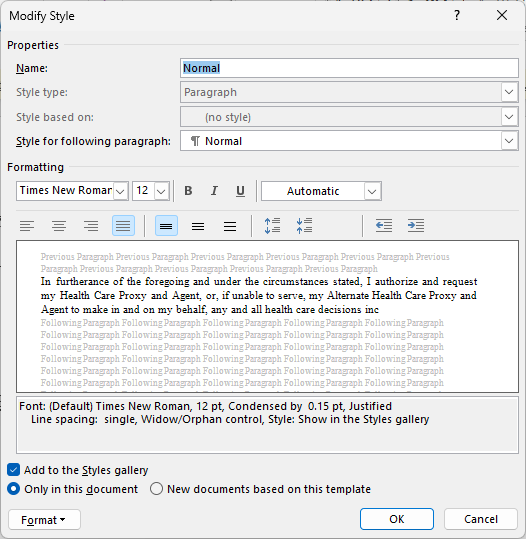

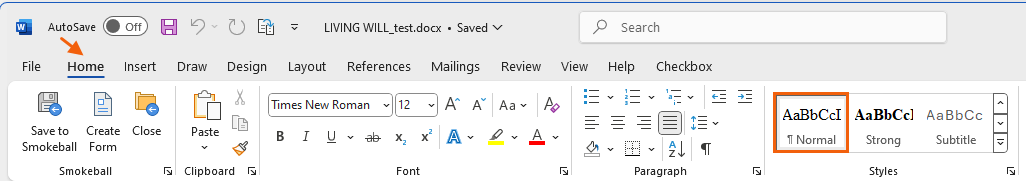

If you experience difficulty in creating automated templates with consistent fonts, we recommend modifying your Normal Style setting in Word to resolve the issue. To do so:
  1. While in Word, navigate to Home and then select Styles.
  2. Right-click on Normal.
  3. Select Modify from the pop-up menu and adjust the following parameters:
    • Choose a paragraph alignment (left, right, center, justified)
    • Choose a spacing option (single, 1.5x space, double space)
    • Select a font (Times New Roman, Arial, etc.)
    • Select a font size
  4. Select OK to save your selections.

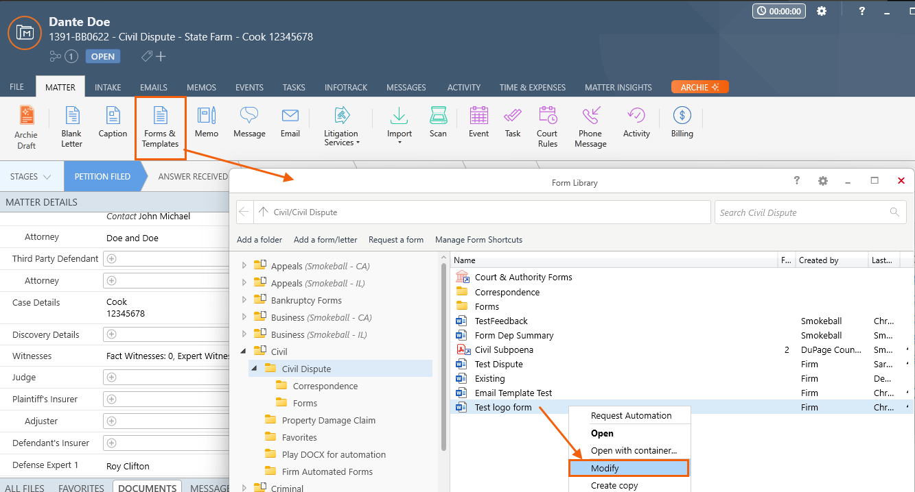

    • You can access modify mode from the document's matter by selecting the Forms & Templates button, clicking on the document you wish to review, and then selecting Modify.

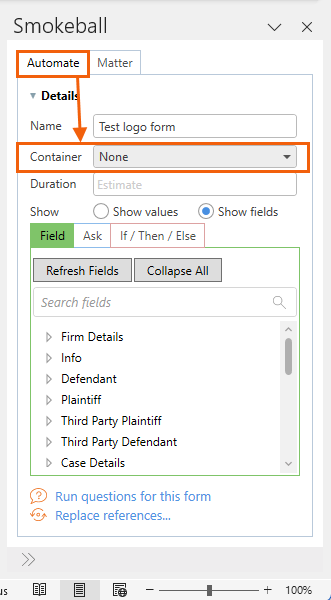

  2. To check if a template is attached to a smart letterhead, expand the arrow icon next to Details under the Smokeball toolbar to see which smart letterhead, if any, is attached. You can then try to modify the smart letterhead to resolve the issue by checking the Normal Style of the container (proceed to the next step).

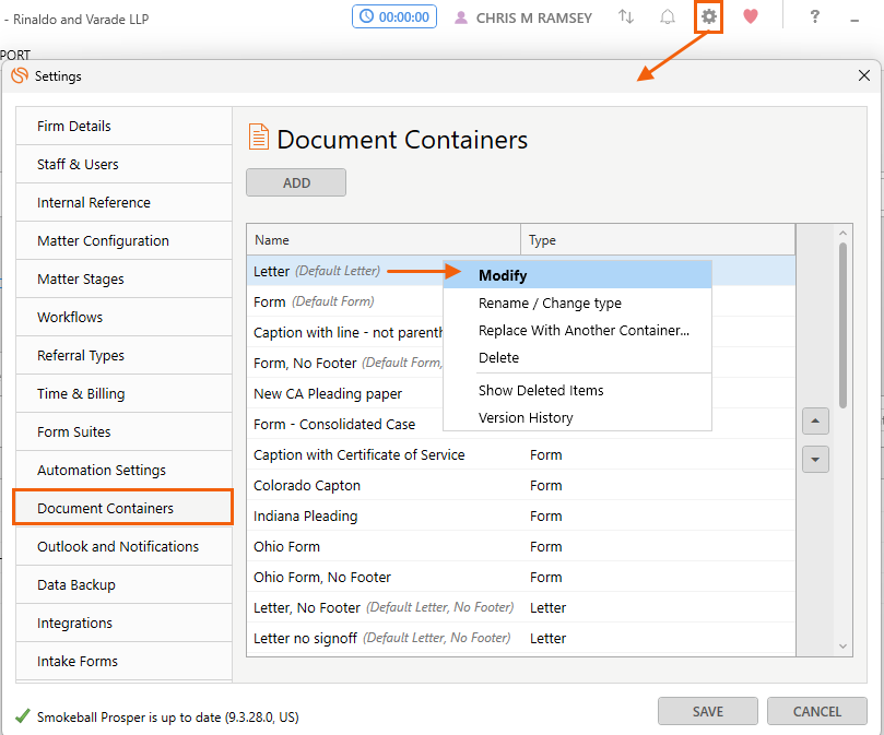

  3. To adjust the Normal Style of a smart letterhead, navigate to Smokeball Settings > Document Containers. Right-click on the container you wish to review and select Modify.
  4. Make any needed changes to the Normal Style and then select Save & Close from the Smokeball Word ribbon.

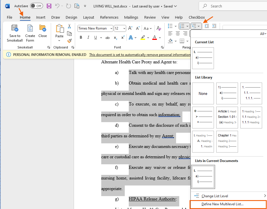

  1. In Word, select the text or numbered list you need to change.

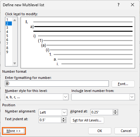

  2. From the Paragraph group on the Home tab, click the arrow next to Multilevel List and then click Define New Multilevel List.

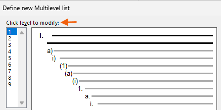

  3. Expand the Multilevel list dialog box by clicking More in the lower-left corner.
  4. Choose the list level you need to modify by selecting the list. By default, "1" is selected.

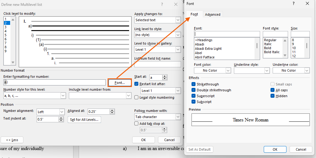

  10. To change the font size, style, and color, click Font and choose a setting on the Font tab or Advanced tab.
    • Use the Font tab if you need to change the bullet font, style, size, color, underline style, underline color, and related effects.
    • Use the Advanced tab if you need to change the bullet font character spacing and OpenType features.

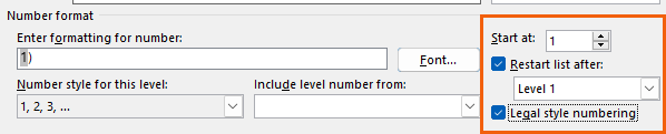

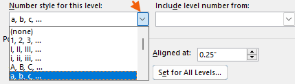

  11. Click the down arrow next to Number style for this level and choose numbers, letters, or another chronological format to change the style. Specify a level number in the Include level number from: field.
  12. Select a number to start the list. By default, this value is "1." To restart numbering after a specific level, select the Restart List After checkbox and choose a level from the list.
  13. Select Legal Style Numbering to enforce a legal style on the multilevel list.
