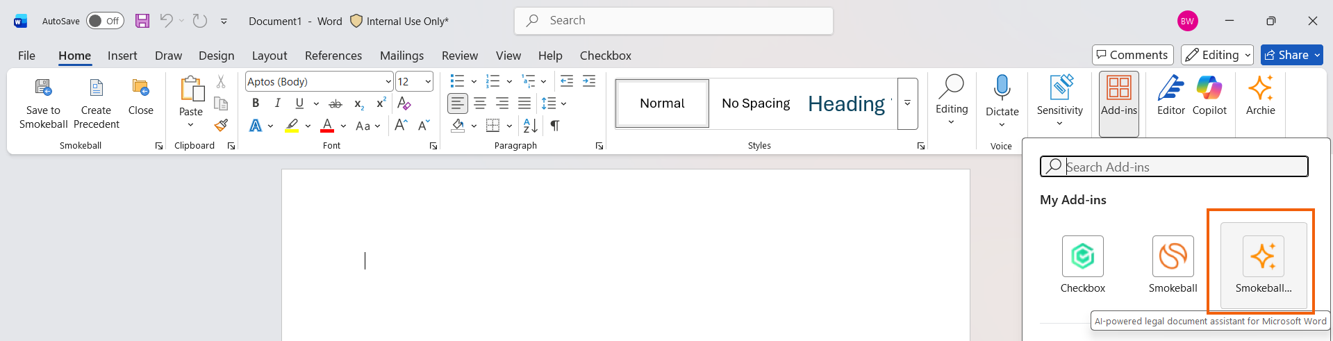

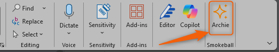

  1. Open the Microsoft Word App on your PC.
  2. The Archie Word Add-in may already be installed and active. You can verify this by checking for the Archie Icon on the top right of Word
    • If there, click on it to pop the Archie side bar!

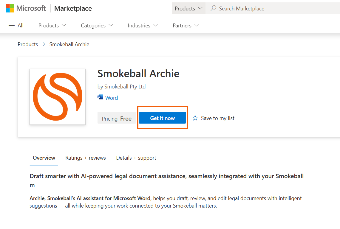

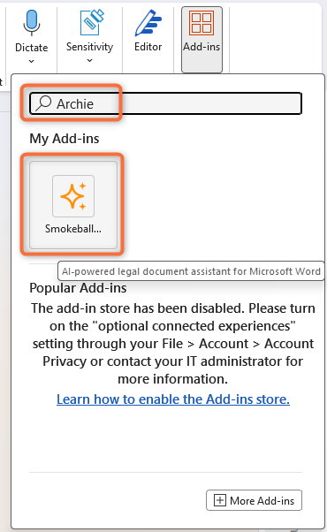

  3. If not there, select Add-ins, located on the right-hand side of the Word ribbon.
  4. Search for "Archie" and select the Smokeball Archie add-in.
  5. If not there, select More Add-ins and click on the Store tab to open the Microsoft add-in store.
  6. Search for "Archie" and install the Smokeball Archie add-in.

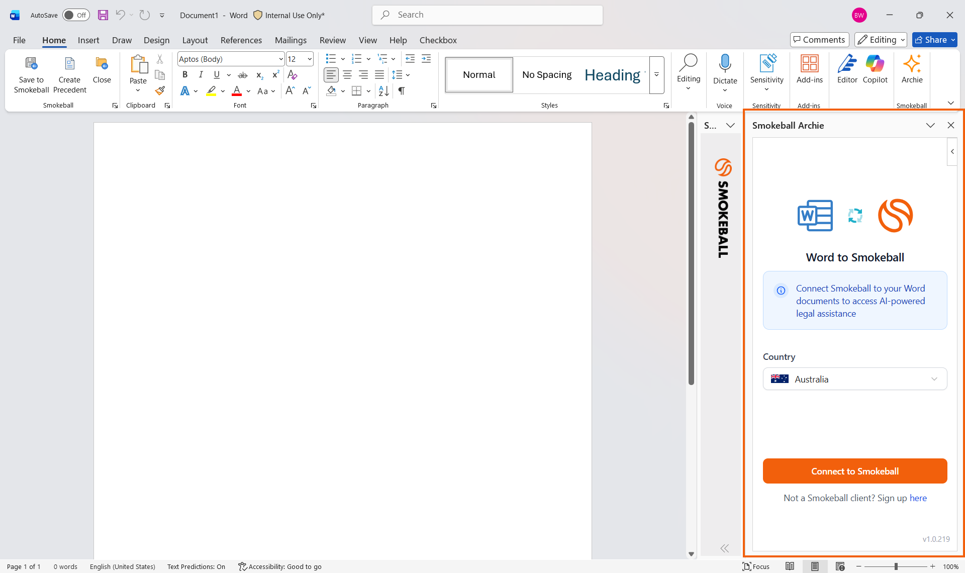

  7. Select Add-ins again on the Word ribbon and click on Smokeball Archie.
  8. The Archie Word add-in will appear on the right-hand side of Word. Log in with your Smokeball email, password and 2FA code when prompted.

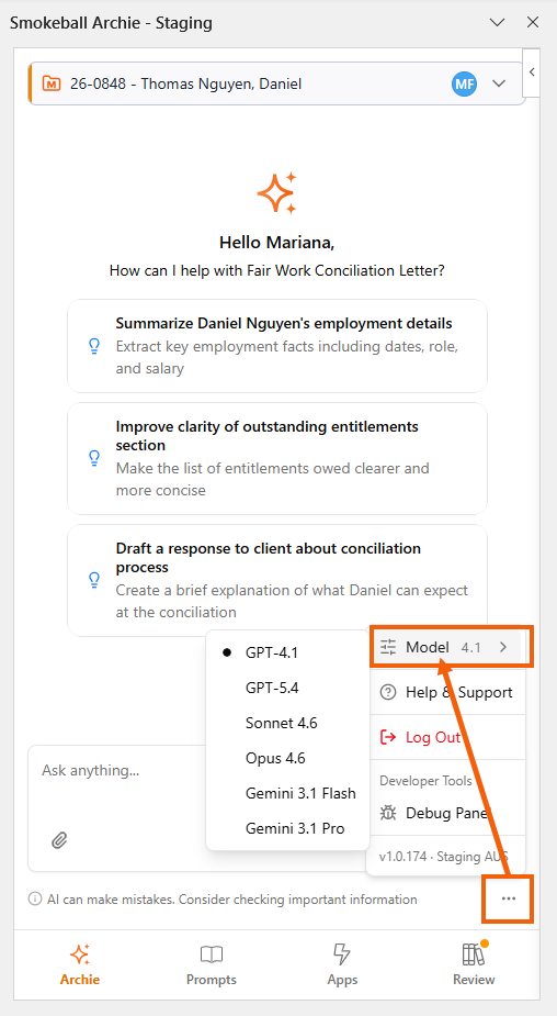

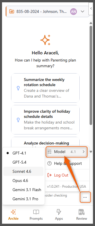

Choosing Archie's AI model
Select the Ellipsis icon under the chat text box to specify which AI model Archie should use.
Microsoft Word supports a different set of Archie AI models compared to those available when using Archie in your matters.
Here's a helpful guide on each of the models available for Archie in Microsoft Word:
  • OpenAI GPT-4.1 - A dependable all-rounder that's especially good with long or multiple documents. It can read large contracts and document sets in one go without losing track and is reliable at following detailed instructions.
    Use it when: you're working across long documents or several files at once or need Archie to follow precise drafting instructions.
  • Gemini 3.1 Flash The fast, efficient option. It keeps up with everyday work at speed without a big drop in quality and can put in extra effort on trickier questions when needed.
    Use it when: you want quick answers for routine work — summaries, quick questions, straightforward drafting — and when responsiveness matters most.
  • Gemini 3.1 Pro The top-end model for the hardest work. It reasons more deeply and is the strongest choice for complex matters, cross-document analysis, and spotting conflicts or ambiguity across a file.
    Use it when: the matter is complex or high-stakes and getting it right matters more than speed.
    NOTE: If wanting to draft long documents using Archie, the Gemini Flash model is a better fit since its output capacity is larger compared to the Gemini Pro model.

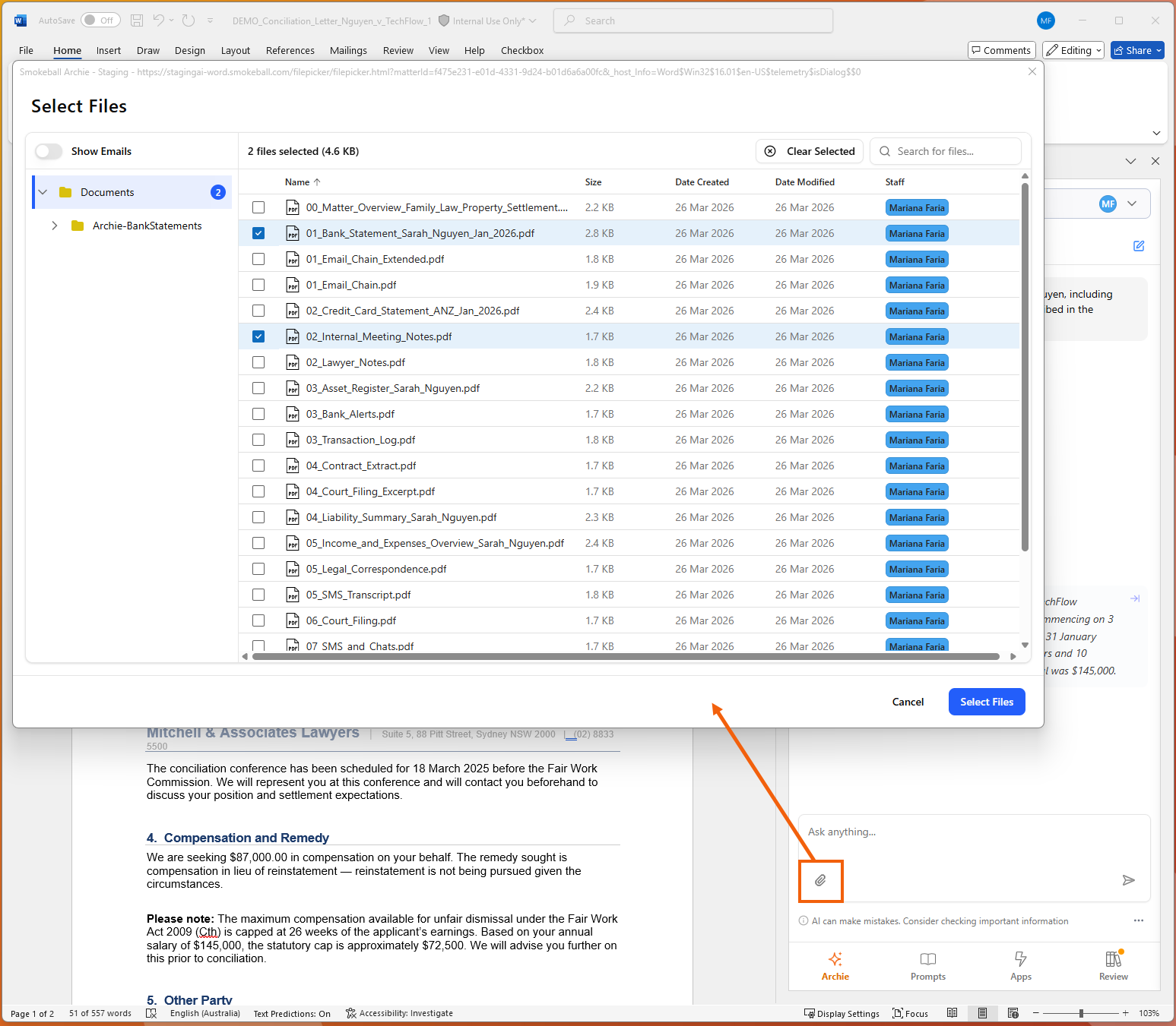

You can attach additional documents from the matter to help with providing additional context to Archie. Select the Paperclip icon and choose one or more files from your matter's documents list.

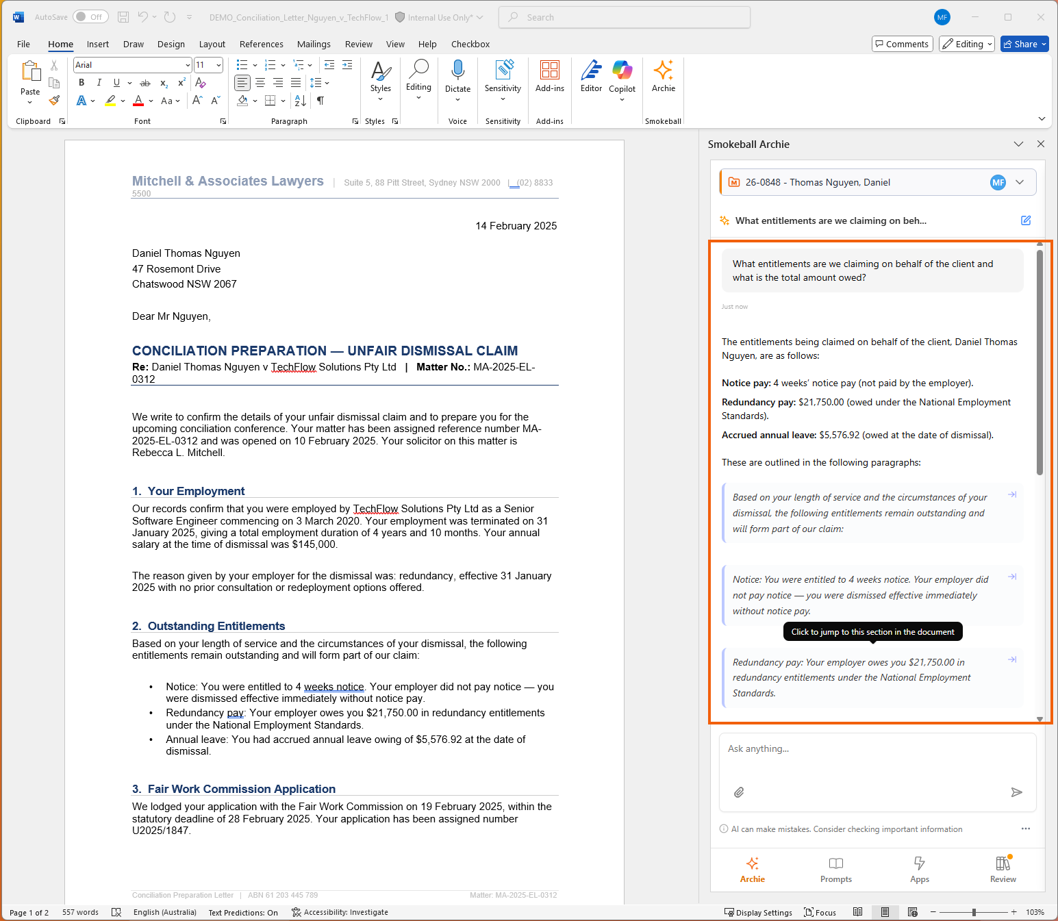

Extracting key information
Ask Archie to extract key information from the document so you don't have to read through the entire document.
Document citations are linked at the bottom of the Archie output. Click on a citation to jump to the location of the Word document it is referring to.

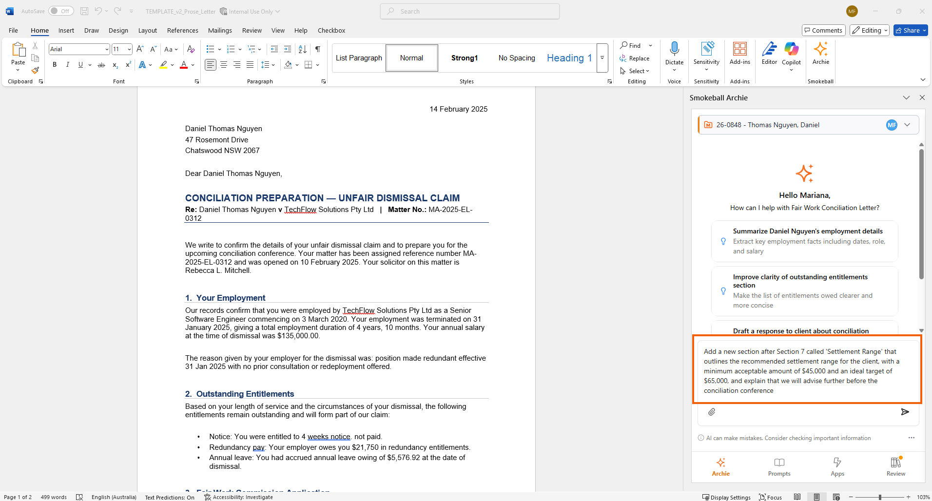

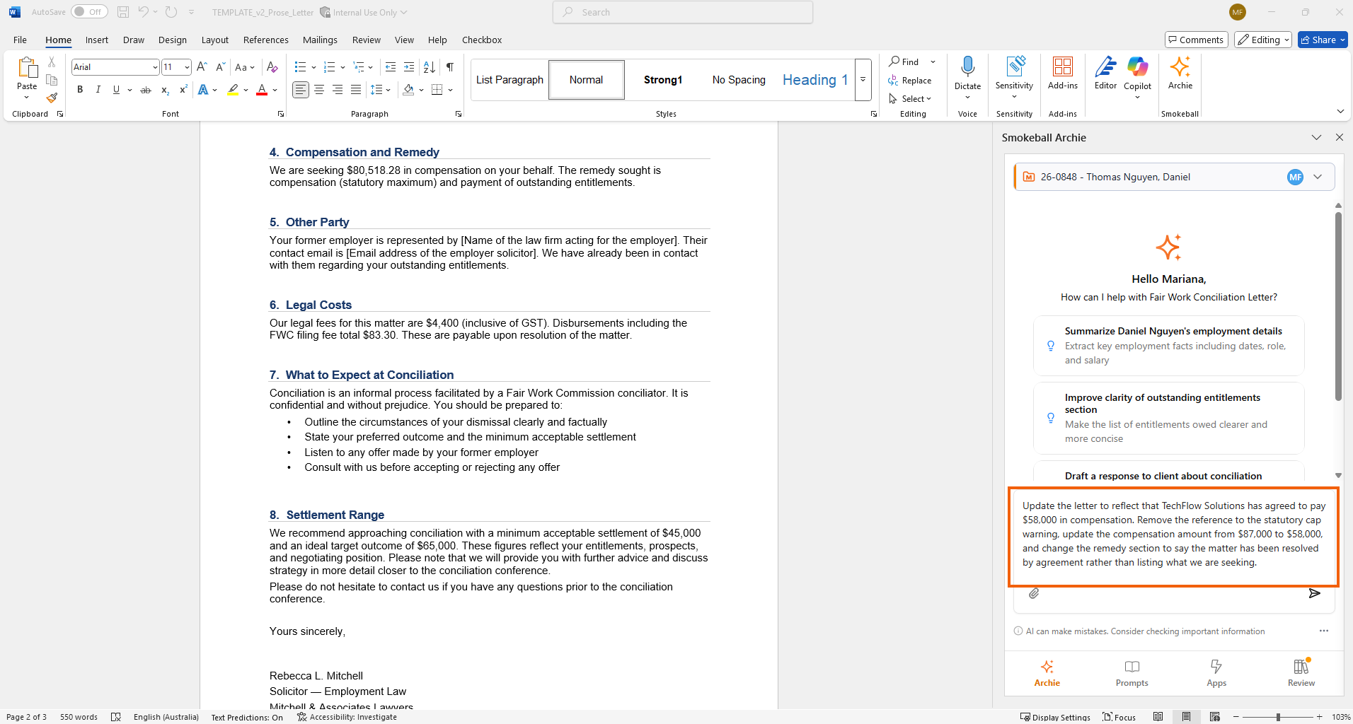

Editing and adding content to the document
Ask Archie to edit or rewrite specific parts of the document.
You can also ask Archie to generate and insert new content (such as a section) into the document.

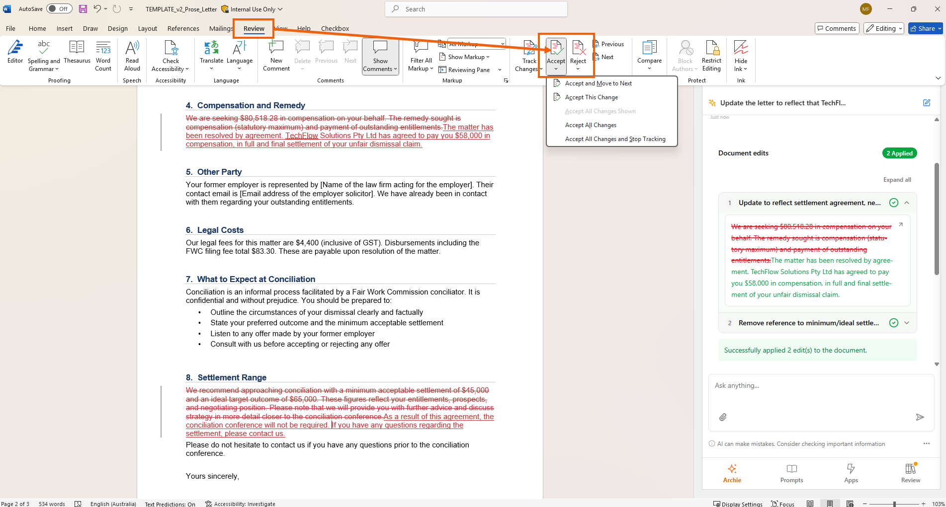

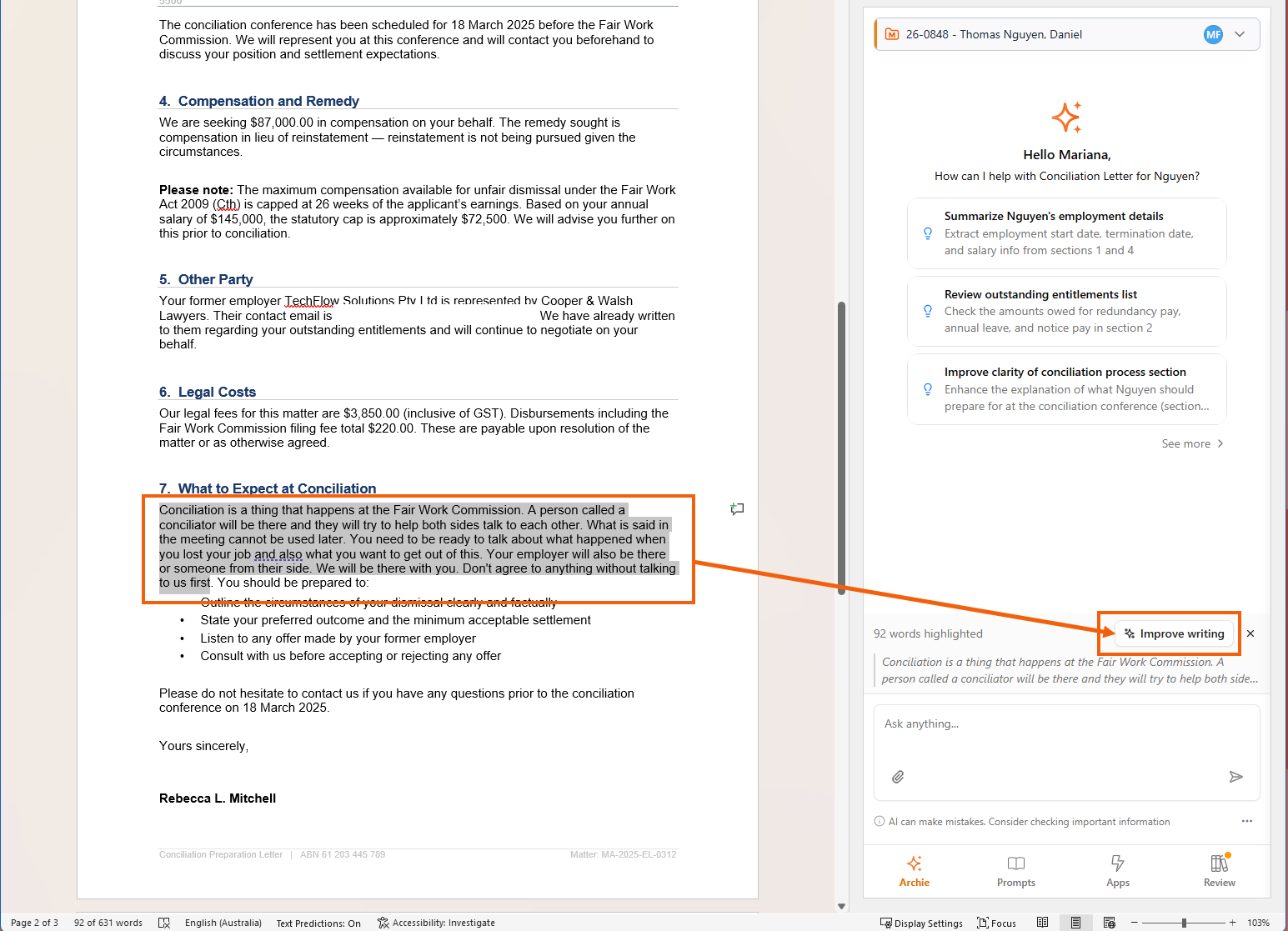

Selecting text in the document will make the Improve writing button appear above the chat box. Clicking on Improve writing makes Archie analyze the selected text and generate a clearer version of the text while preserving its original meaning.

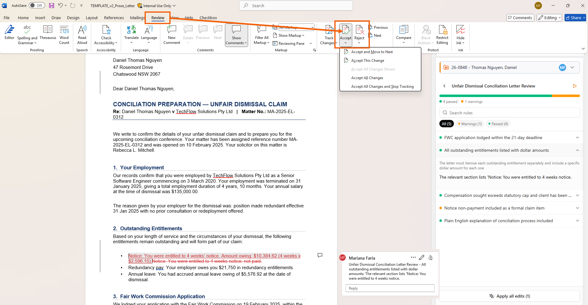

Archie will utilize the Tracking functionality in Word to log the changes to the document. Navigate to Review Tab > Accept/Reject buttons in the Word ribbon to accept or reject Archie's suggestions.

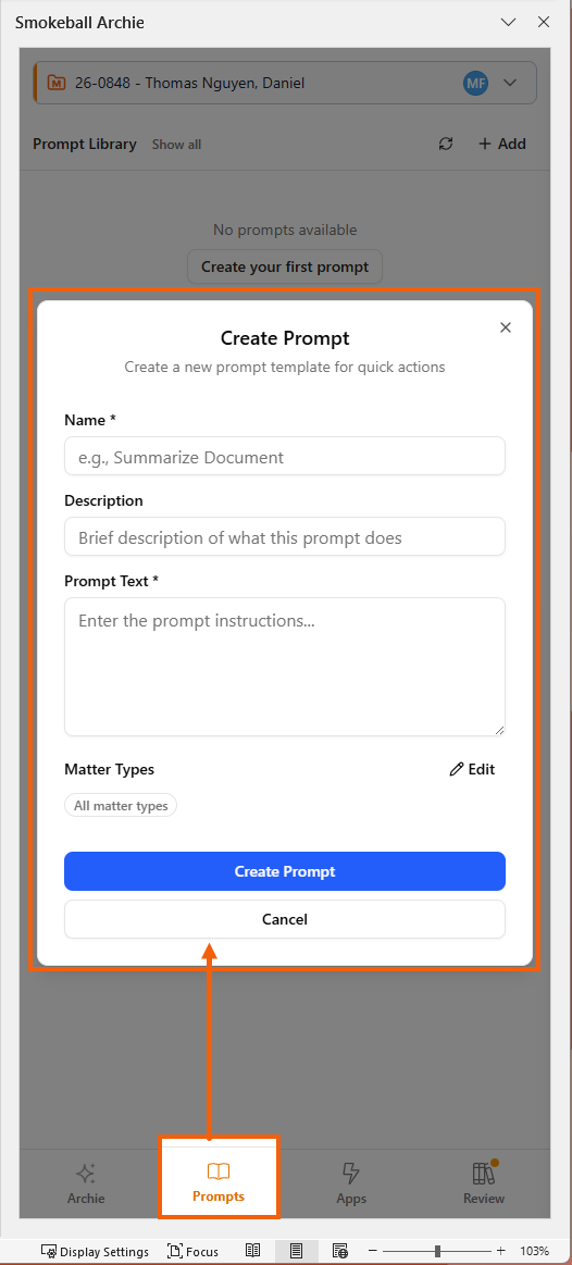

Saving commonly used document prompts
The Prompt tab located at the bottom of the Archie panel is where you can save commonly used prompts to the Word add-in. This Prompt Library is separate to the one used in the Archie tab in Smokeball, as it's designed for storing document-focused prompts, while the regular Prompt Library supports broader use cases.

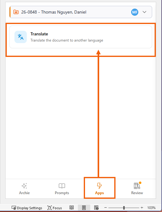

Using Archie Word add-in Apps
Select the Apps tab located on the bottom of the Archie panel to view and use apps that are connected to the Archie Word add-in.

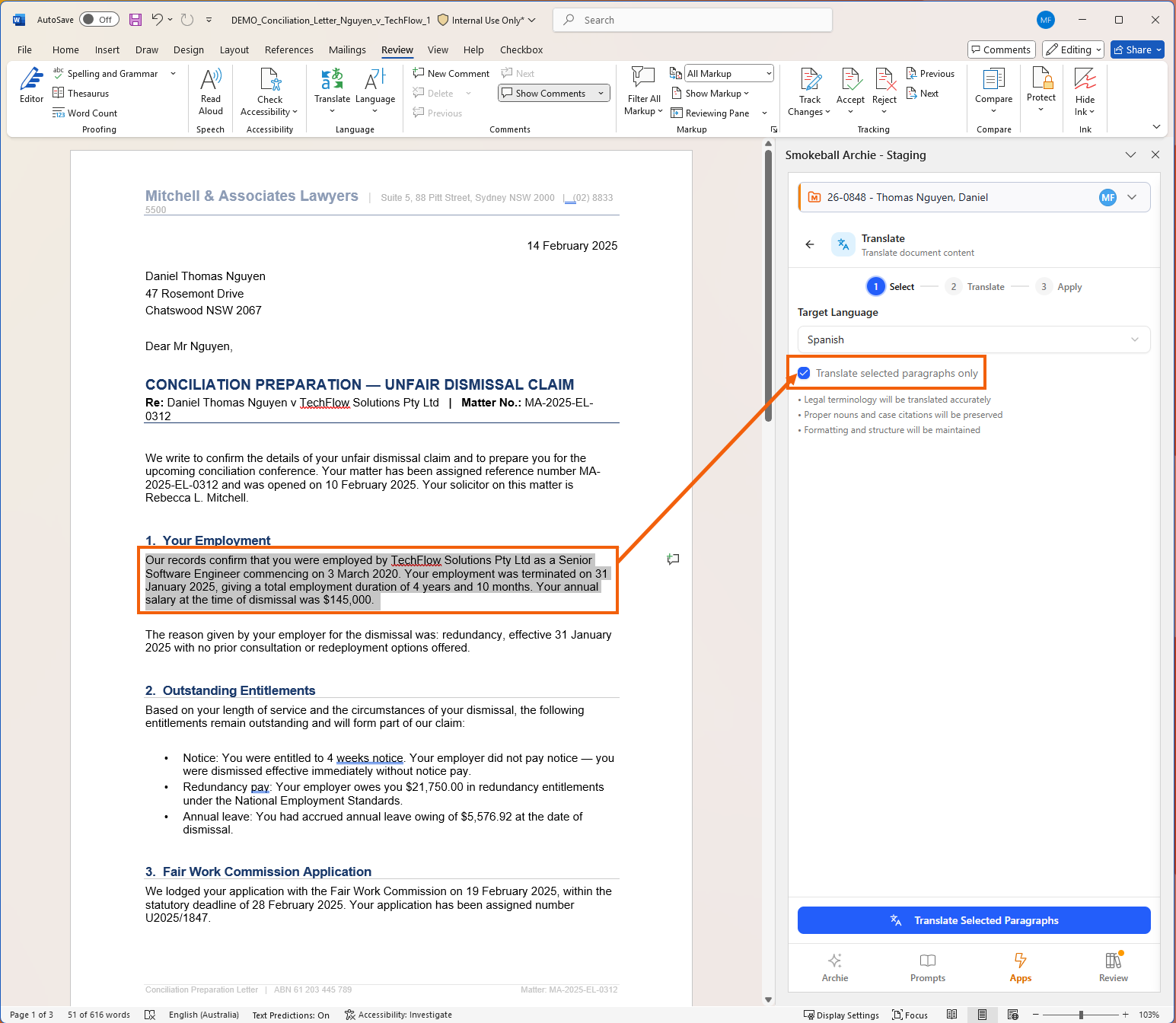

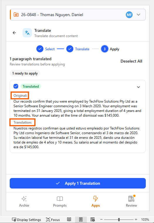

Translate App
Currently the Archie Word add-in has one app - Translate. The Translate app allows you to translate selected text or entire documents into other languages.
If you select a section of text in the document, the option to Translate selected paragraphs only will be selectable.
Once the text has been translated, the original and translated versions are put side-by-side to help you review and compare.

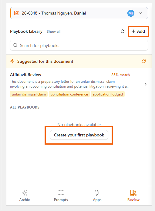

Creating a Playbook
To get started:
  1. Select Review on the lower right side of the Archie panel, then select Create your first playbook or +Add.
  2. Enter a Name and Description of the Playbook.
  3. Choose the Matter Types that this Playbook should appear on.
  4. Select Add Rule. Rules are notes that Archie should check the document for to determine if it follows them. Refer to the example below for some ideas you can incorporate.
  5. Select Create Playbook.

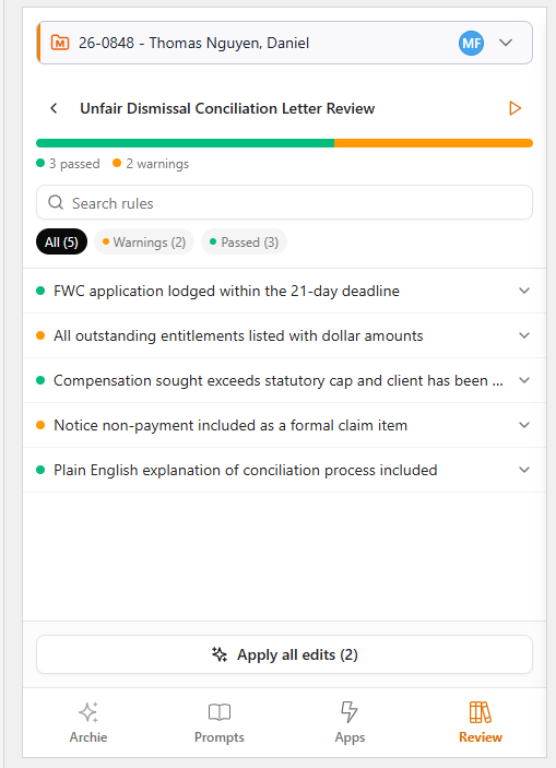

To run a Playbook, click on it from the Review tab. Archie will then start the document review based on your defined rules in the Playbook.
Archie will then flag sections of the document that have passed review, and sections that need further attention.

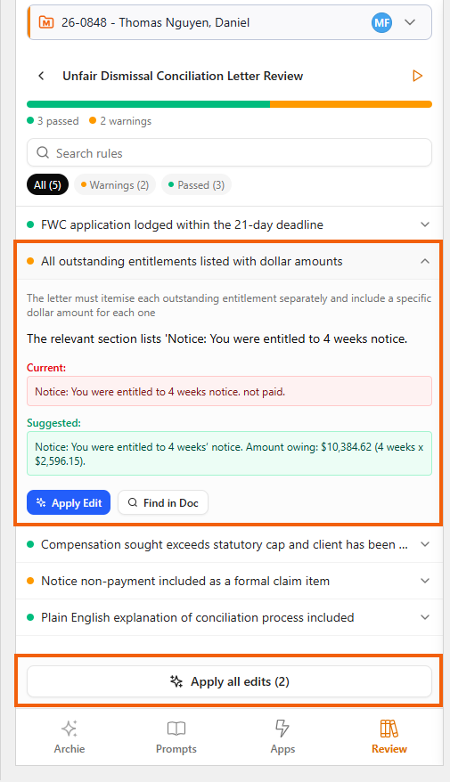

Click on a rule to view more detail and review Archie's suggestion (if an orange Warning was applied). You can then select Apply Edit to apply the suggestion to the document, or select Find in Doc to jump to the section of the document that has been flagged. You can also select Apply all edits to all warnings at once.
Selecting Apply Edit/Apply all edits will appear as an Archie document edit for a final check before it replaces text. Navigate to the Word Ribbon > Review > Accept/Reject to finalize changes.
If a rule displays as an Issue (denoted in red), this means you will need to take further action to rectify the rule in the document. Clicking on the issue will give you more details.
