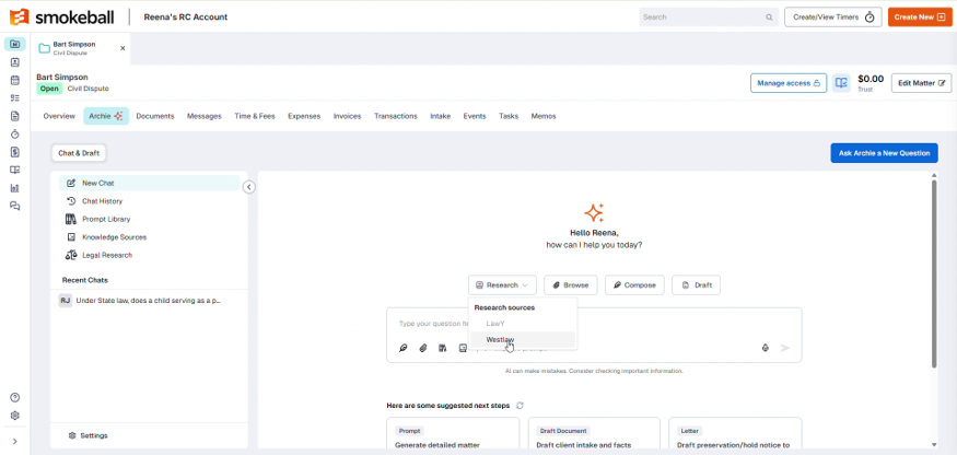

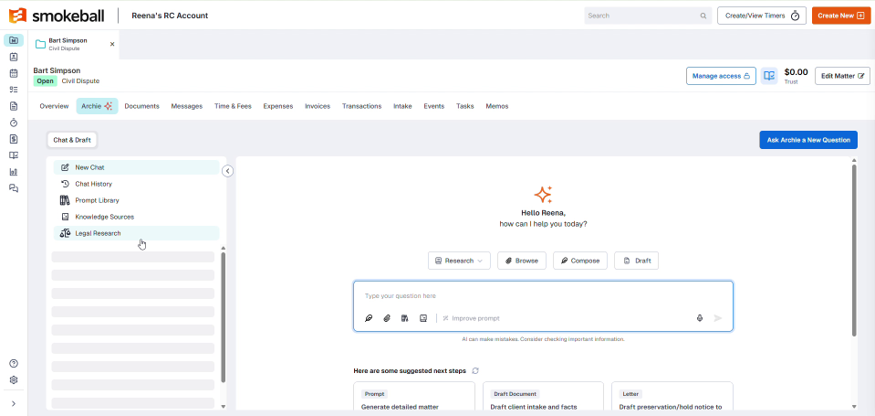

  1. Open a matter in the Smokeball Desktop App or Web App and select the Archie tab.

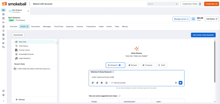

  2. Select Research above the chat box, then choose Westlaw. A tick shows it is selected.

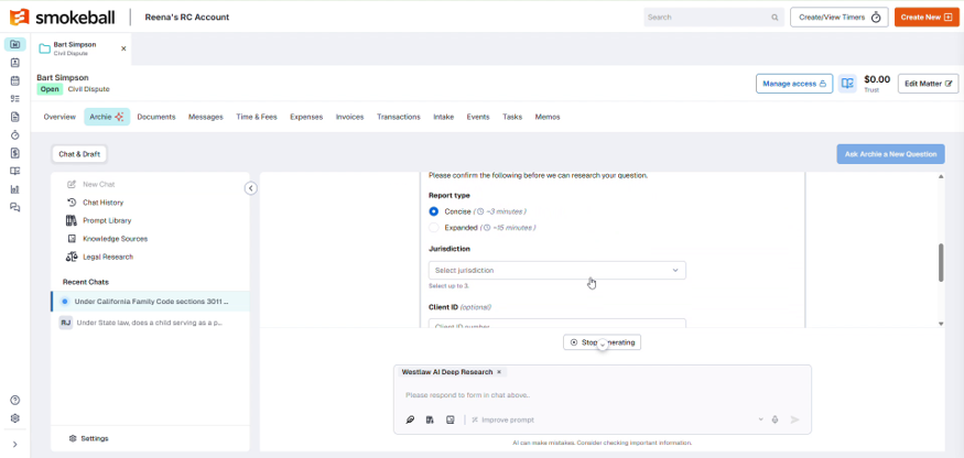

  3. Type your legal question in plain language and send it. A Westlaw AI Deep Research chip appears in the chat box.

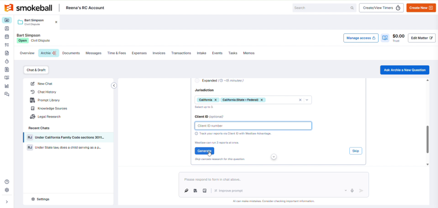

  4. Archie asks you to confirm the research options. Choose your report type, up to 3 jurisdictions, and an optional Client ID. See the table below.
  5. Select Generate. Select Skip to cancel research for this question.

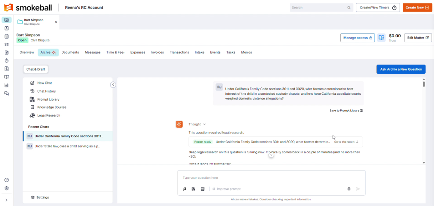

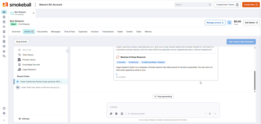

  6. Your report starts to generate. You can carry on with other questions while it runs.
  7. When it is finished, a Report ready message appears. Select Go to the report.
Report options
Option Details
Concise report About 3 minutes. A brief overview of a legal issue. Best for quick questions or simple legal queries.
Expanded report About 15 minutes. Deep analysis with arguments and authority on both sides. Best for more complicated issues, or when you want to think beyond the black-letter law.
Jurisdiction Choose up to 3. Many states offer two options: the state alone, or the state plus federal courts. There are also broader options such as all state courts or all federal courts.
Client ID (optional) A Thomson Reuters Client ID used to track your reports with Westlaw Advantage. It is not a Smokeball client number.

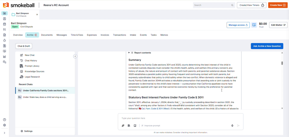

Reading your report
The report opens with a summary, then works through the authority issue by issue. Each proposition carries a citation. The report includes a summary, narrative, arguments and rebuttal, a case comparison chart, key cites on every source, and the holding on every case.

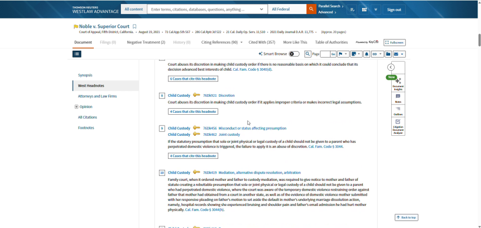

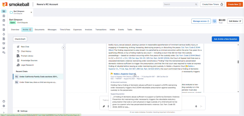

Citations and KeyCite flags. Hover over a citation to preview the case, including any flag from KeyCite (Westlaw’s check on whether authority is still good law), an AI document summary, and the supporting section. Select the citation to open the full source in Westlaw. The first time you do, Westlaw may ask you to sign in.

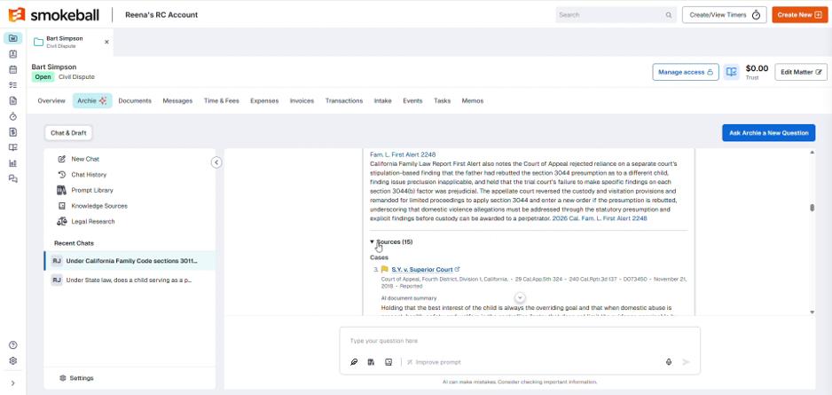

Sources. The Sources list at the end of the report shows the cases the report relied on. Secondary sources and Practical Law practice notes are listed where used.
Verify before you rely on it. Open the key cases in Westlaw, check the KeyCite flags, confirm the jurisdiction matches your matter, and apply your own professional judgment.
