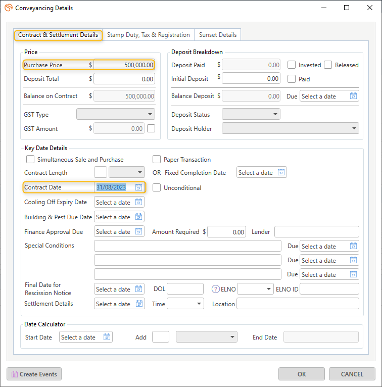

Conveyancing Details: Contract & Settlement Details
  1. Go to the Conveyancing Details layout and select the Contract & Settlement Details tab.
  2. Enter the Purchase Price.
  3. Enter the Contract Date (or leave blank to use today's date).

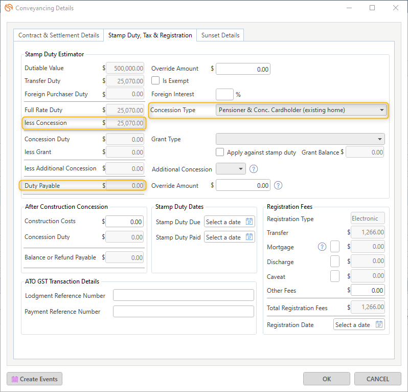

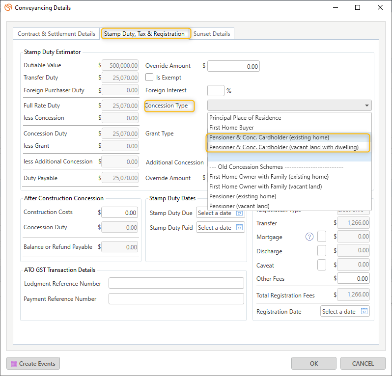

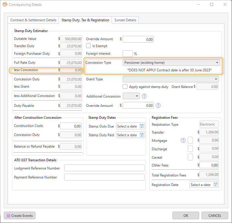

Conveyancing Details: Stamp Duty, Tax & Registration
  1. Select the Stamp Duty, Tax & Registration tab.
  2. Enter Foreign Interest percentage (if applicable).
  3. Select a Pensioner and Concession Cardholder concession type.
  4. The reduction (if within the threshold) will be calculated, showing the Concession amount in less Concession and the total Duty Payable. For example:

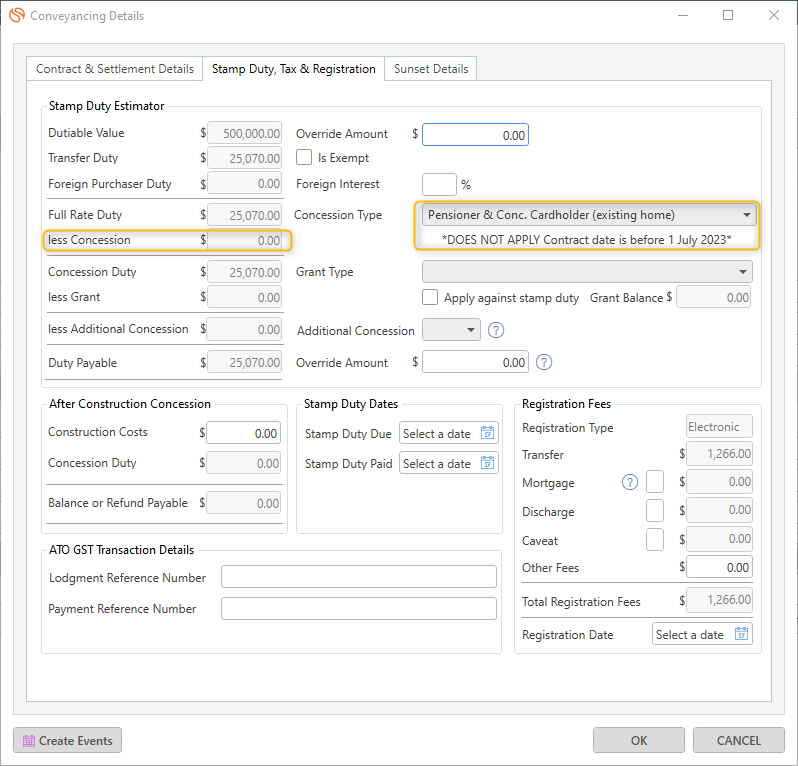

    NOTE: If the contract date is before 1 July 2023 an alert will appear and no reduction will apply:
    • If the contract date is before 1 July 2023, Pensioner (existing home) and Pensioner (vacant land) concession types are still available for selection in the drop-down list under Old Concession Schemes.
    • If the contract date is on or after 1 July 2023 and Pensioner (existing home) or Pensioner (vacant land) under Old Concession Schemes is selected, an alert will also appear and no reduction will apply:

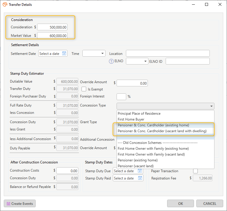

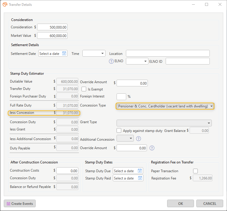

Transfer Matter Stamp Duty Estimator
The Stamp Duty Estimator on Transfer Details will use the dutiable value (consideration or market value, whichever is greater) together with the Pensioner and Concession Cardholder concession type:
To calculate the reduction (if within the threshold), see the Concession amount in less Concession and the total Duty Payable. For example:
