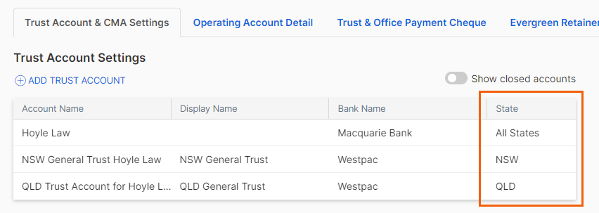

  • The matter is in a different State than the trust account that is connected to Stripe.
    • For example, your firm's NSW trust account is connected to Stripe, but the matter you are sending the invoice from is a VIC matter.
    • Navigate to Firm Settings > Accounts > Trust Account & CMA Settings to ensure the correct state has been selected in the trust account.
