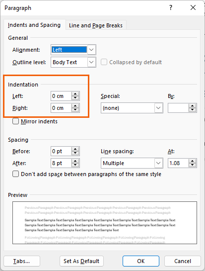

  2. Select the arrow icon on the bottom-right corner of the Paragraph section in the Word Toolbar.
  3. The Paragraph window will open.
  4. Ensure the Left and Right fields under Indentation are set to 0 cm while in Normal Style.
  5. Select OK.
  6. Ensure these Indentation settings have been applied to the whole Precedent Document (not just to the paragraph).
  5. Select OK.
  6. Ensure these Indentation settings have been applied to the whole Document Container (not just to the paragraph).

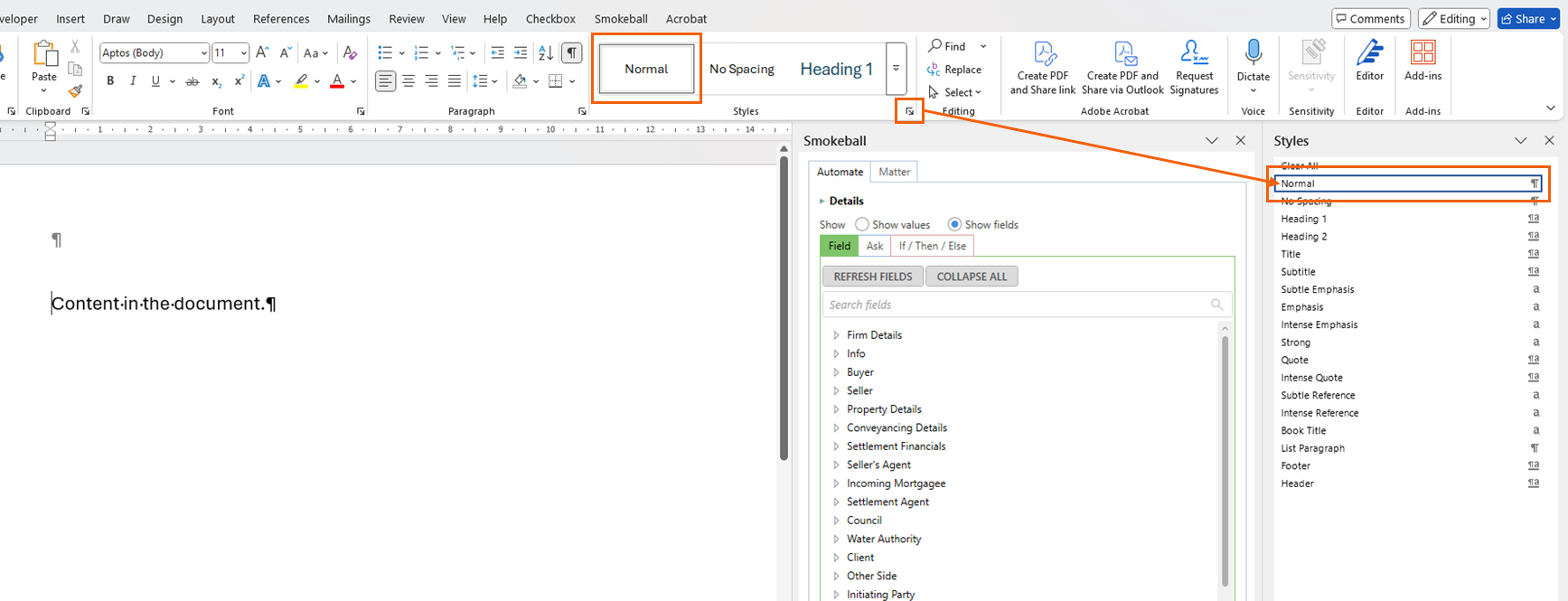

  2. Check that the Normal Style is selected in the Styles section of the Word Toolbar.
    Click on the arrow icon on the bottom-right corner of the Styles section, which will open the Styles Toolbar. When you click on a line in the document it will tell you which Style is applied.
    The whole precedent must use Normal Style as a foundation, then you can apply other Styles (so long as the Styles used are set up the same as in the Document Container that this Precedent is linked to).

  2. Check that the Normal Style is applied in the Styles section of the Word Toolbar. You will have to check each line/paragraph. The Styles toolbar will not open when in Modify mode in a Document Container.

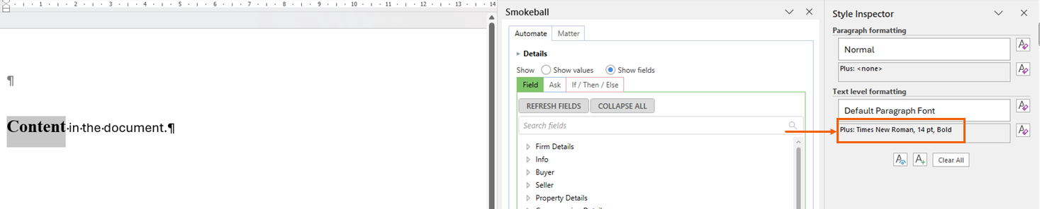

  2. Click on the text in the document you are checking and click on the arrow icon on the bottom-right corner of the Styles section.
  3. Select Style Inspector on the bottom of the Styles popup.
In this example the Style Inspector tells you that Normal Style is applied PLUS Bold formatting:
This means that when the document is generated/opened from within your matter it will:
  • First apply the Normal Style from the Document Container;
  • Then it will apply the Bold on top of that.
However, if other type of changes have been applied to the Precedent on top of the Normal Style (e.g. different Font type or size), these settings will also override the Document Container settings.
For example here, the Font type and size has been applied in the Precedent on top of the Normal Style:
