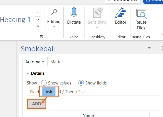

  2. Click Ask from the Smokeball panel on the right.
  3. Click Add.

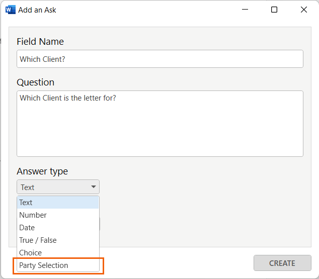

  4. Fill in the Field Name and the Question. The Question will appear above your selection options when using the document.

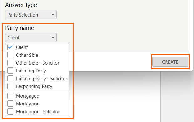

  5. Choose Party Selection from the Answer Type drop-down menu.

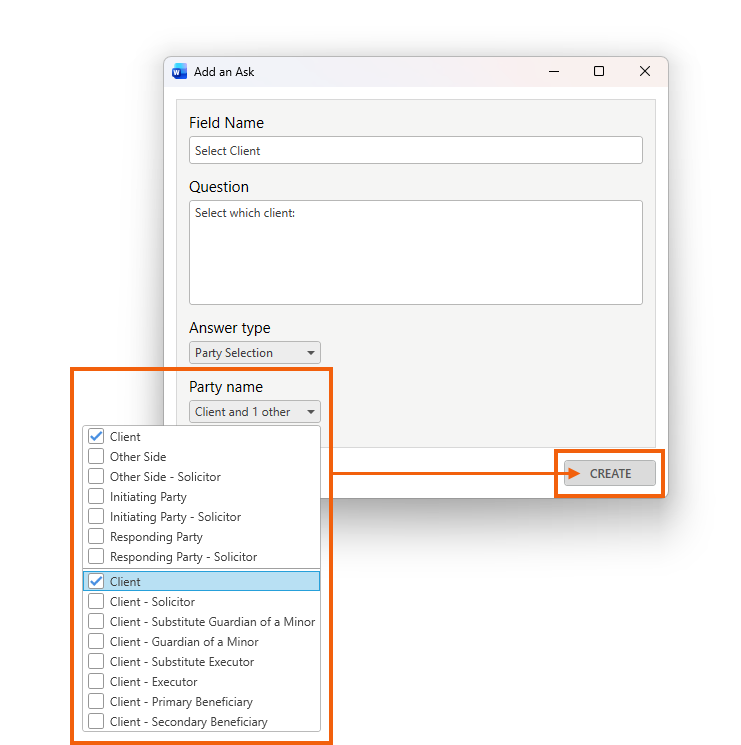

  6. Choose the appropriate party from the list and then click Create.
    Note: Some Matter Types have Contact Cards with their own Sub-Layouts, for example, Will matter types will have Will Details under the Client Contact Card. In these scenarios, you will see the option for the Contact Card (Client in this example), in two places for the Party name drop down selection. Make sure to select the Contact Card above and below the line.

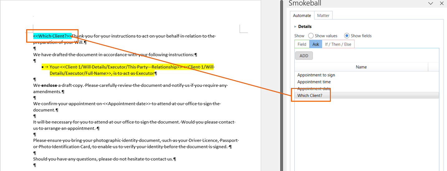

Now that you have created the Party Selection, double-click the Field Name from the list located in the Ask section and insert it into the document. It does not matter where in the document you insert it.
In the example below, it has been placed at the beginning of the document (highlighted in blue).

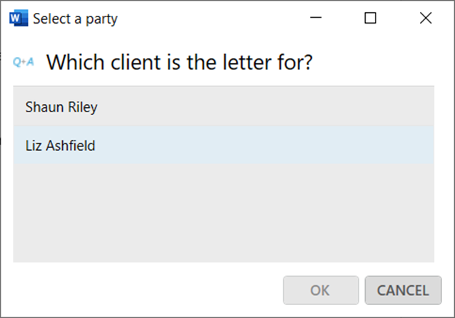

When you use the precedent, and there is more than one party of the selected type, you will be asked to choose which party the document will refer to.
Any fields in the precedent relating to that specific type of party will be updated to refer to the selected one.
