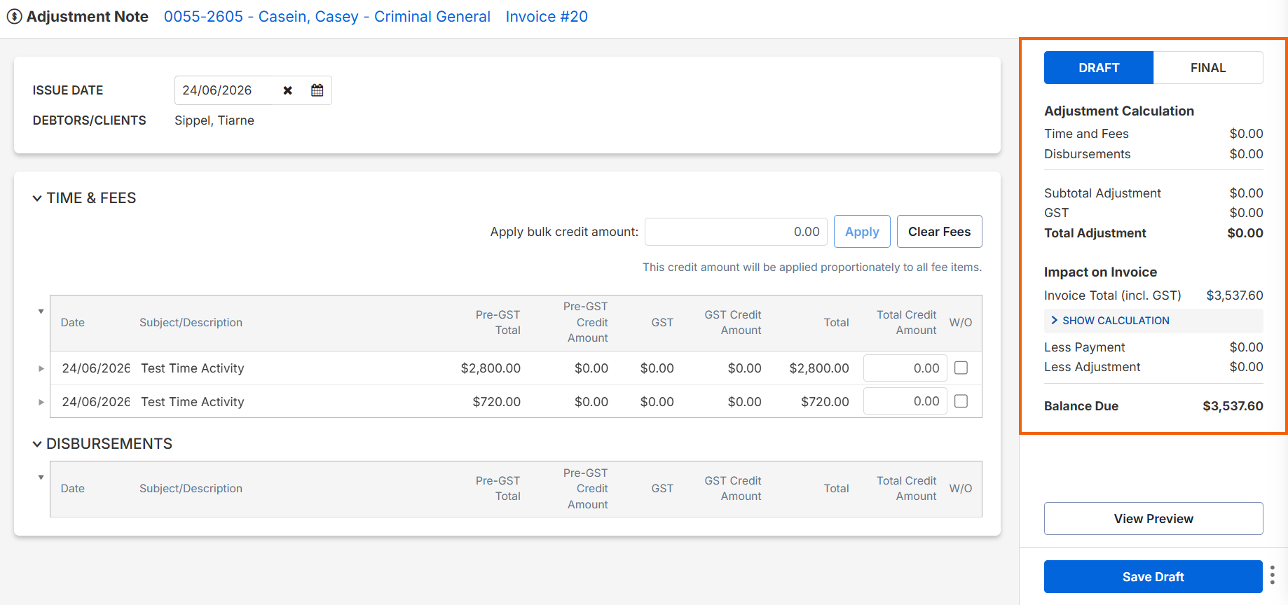

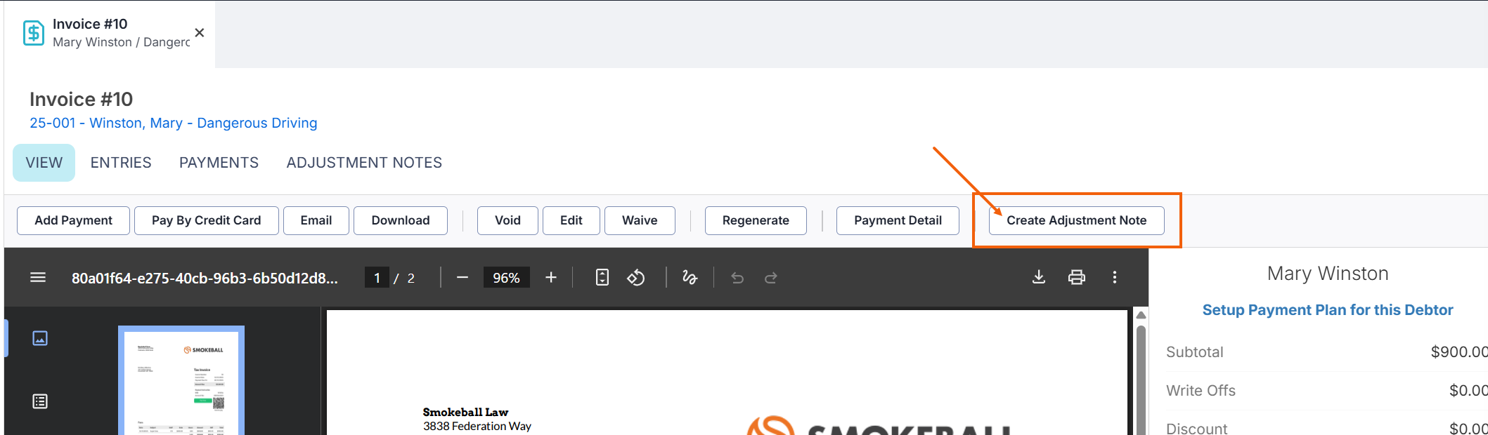

  1. On your finalised invoice, select the Create Adjustment Note button.
  2. Enter the Issue Date. This cannot be earlier than the invoice's issue date.
  3. Choose to apply the credit amount in bulk or per line item.

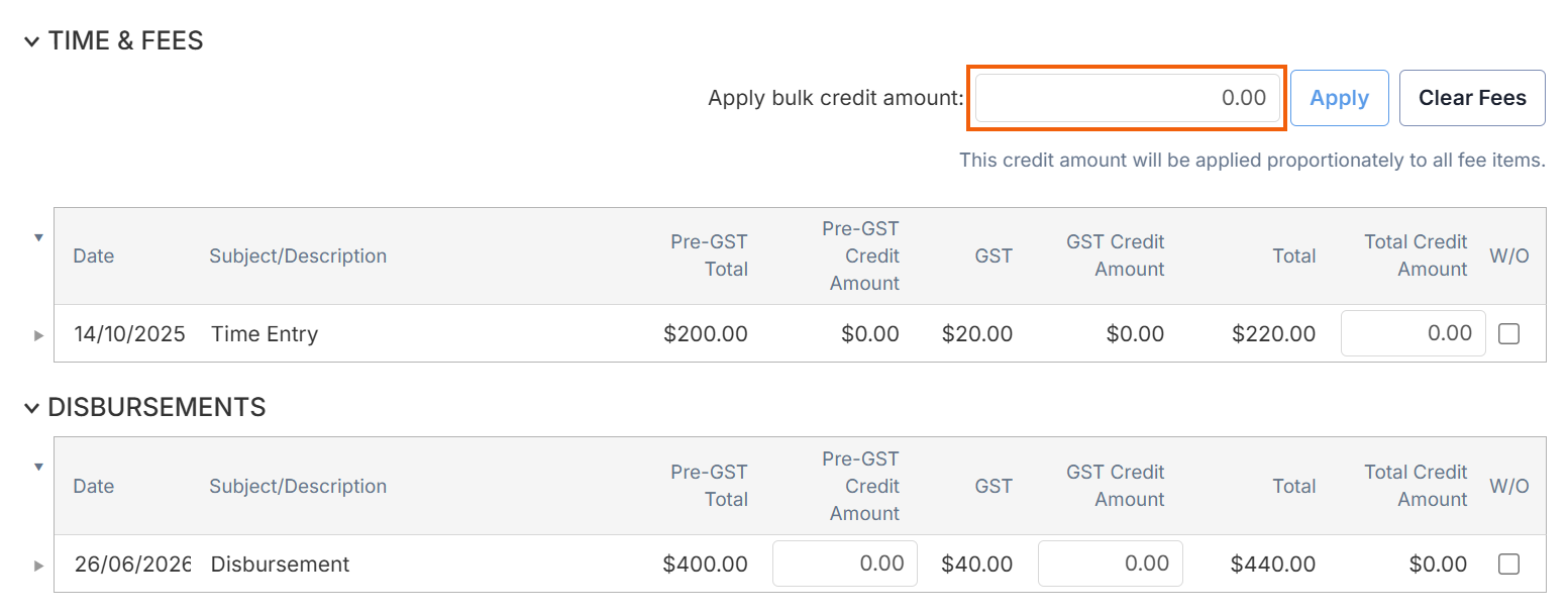

    • To apply a bulk credit amount, enter the dollar amount in the Apply bulk credit amount field, then select Apply. The credit will be spread proportionally across all fee lines, but you can still edit individual lines afterwards.

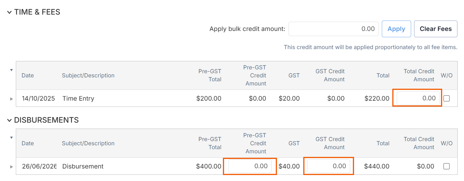

    • To apply a credit per line item, enter a credit amount in the Total Credit Amount field for Time/Fee entries, or enter a credit amount in the Pre-GST Credit Amount and GST Credit Amount fields for disbursements.

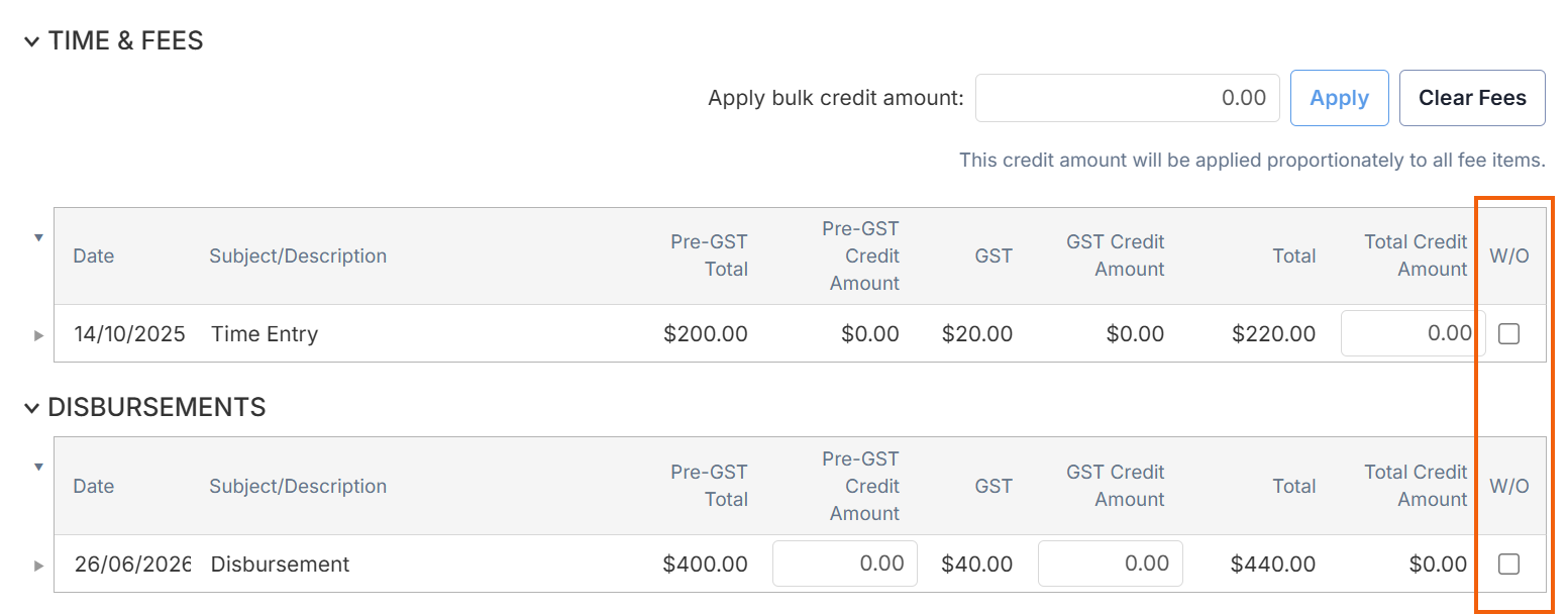

    • You can also Write Off line items by checking the box under W/O for the relevant line item.

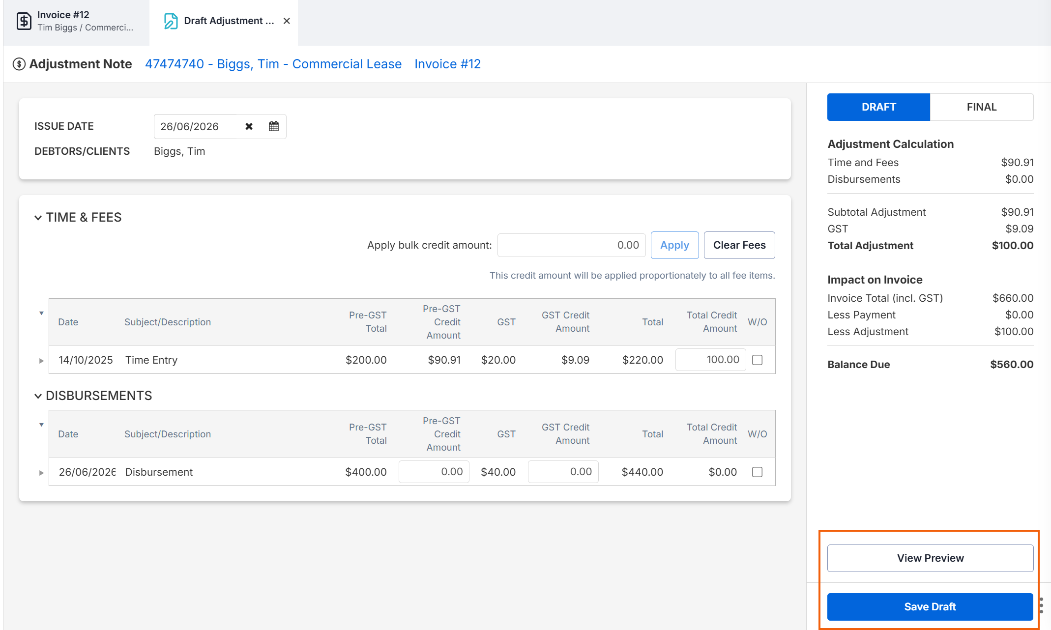

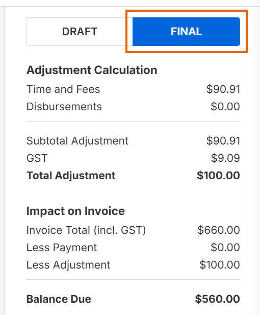

  4. Check the right-hand panel for the breakdown of the adjustment calculation.
  5. View a preview of the draft Adjustment Note by selecting View Preview on the bottom-right corner of the screen. From here you can also save the adjustment as a Draft to work on it later.
  6. Once you are ready to finalise the Adjustment Note, click on Final at the top of the right-hand panel.

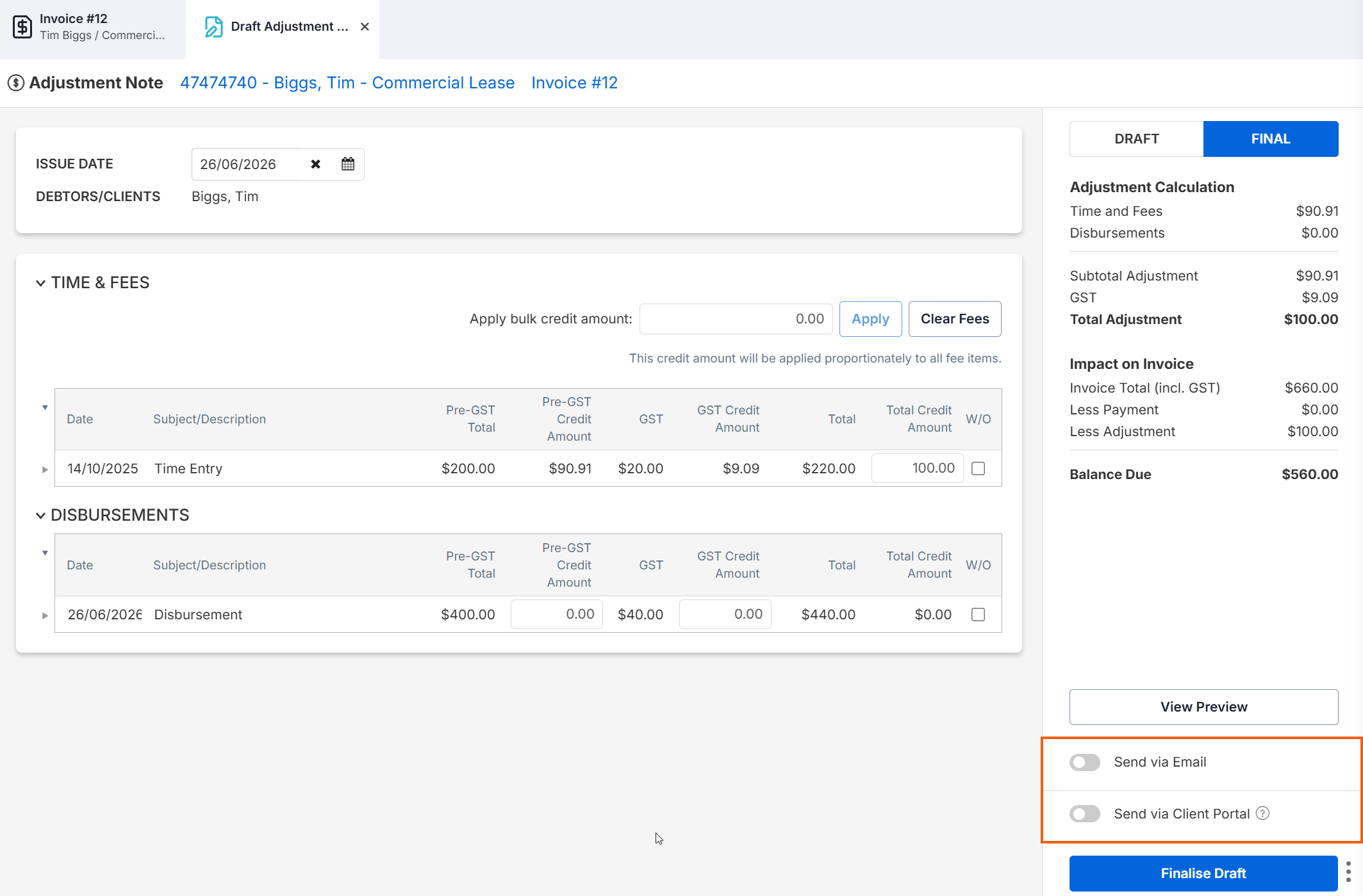

  7. Select Send via Email to email the Adjustment Note to the debtor, or Send via Client Portal if they use the Client Portal. You can also choose to do neither by not selecting any option.
  8. Select Finalise Draft.

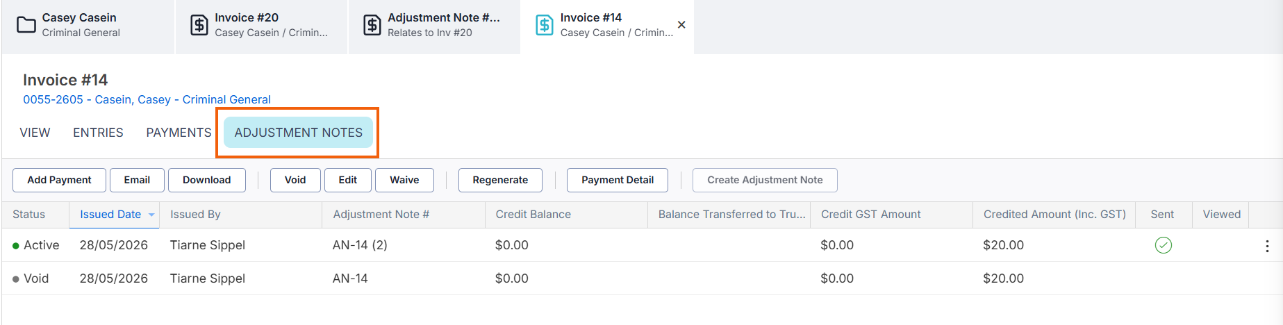

Viewing and managing your Adjustment Notes

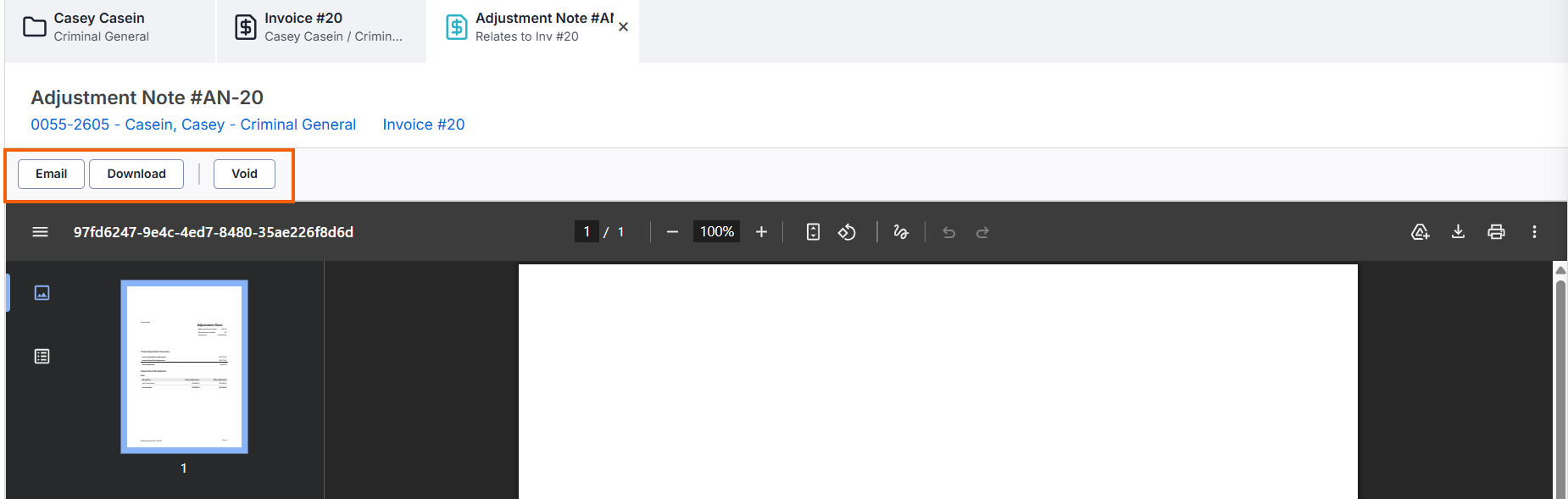

Invoice Adjustment Notes live in the Adjustment Notes tab of the invoice.
Click on the Adjustment Note to view the PDF. From this screen you can Email it, Download it or Void it.

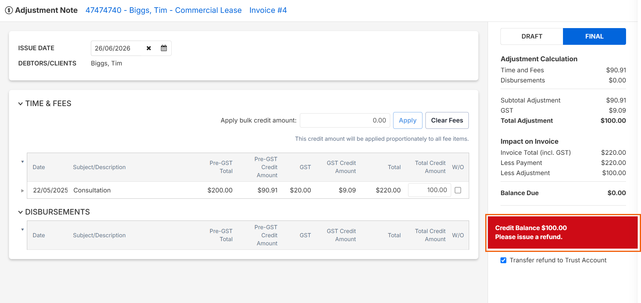

A credit balance appears when the adjustment makes the invoice over-credited (Payments + Adjustments now exceed the invoice amount), so money is owed back to the client. When this happens, a Credit Balance message appears on the right-hand panel when creating the Adjustment Note.
By default, Transfer refund to Trust Account is automatically ticked. Once the Adjustment Note is finalised, a trust deposit transaction is created and linked to this Adjustment Note and the trust account balance is updated. Voiding the Adjustment Note reverses this trust deposit.
