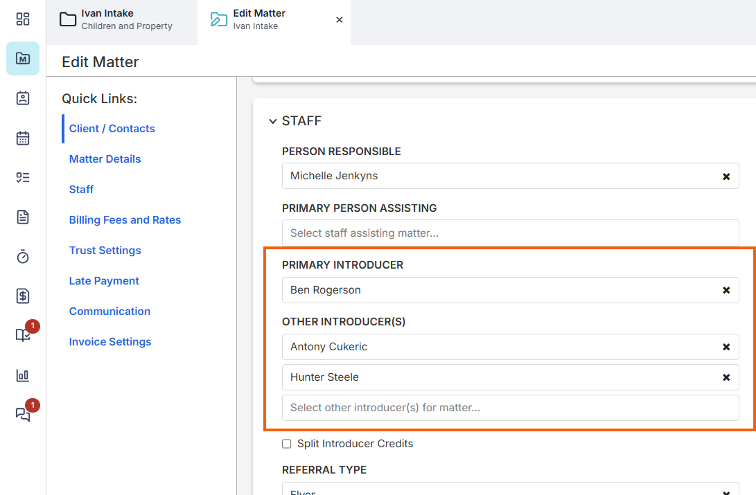

Adding multiple Introducers to a matter
The matter must have more than one Introducer listed before you can enable split Introducer Credits for it.
To add other Introducers to a matter:
  1. Open the matter in the Smokeball Web App.
  2. Select Edit Matter on the top-right-hand corner of the screen.
  3. Scroll down to the Staff section and enter the Primary Introducer (if you haven't already).
  4. Enter the Other Introducer(s) one-by-one.
You can also add multiple Introducers from the Smokeball Desktop App, but we recommend doing so on the Web App so you can seamlessly follow the instructions below to enable Split Introducer Credits.

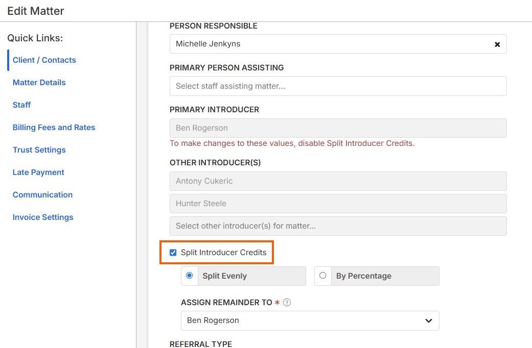

Enabling Split Introducer Credits
Once you have added all Introducer(s) to the matter:
  1. Tick Split Introducer Credits, located under the Other Introducer(s) list in the Edit Matter screen of the Smokeball Web App.
    Note: The list of Introducers cannot be edited while this setting is ticked.

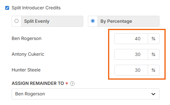

  2. Choose whether credits should be Split Evenly or By Percentage. If you select By Percentage, enter the percentage amounts next to each listed Introducer. The total amounts must equal 100%.
  3. Under the Assign Remainder To field, choose the Introducer who should receive the remainder if there's an uneven split.
    • For example, if a payment is split evenly between two introducers and the payment is $50.01, then the introducer that had the remainder assigned to them would receive $25.01 and the other introducer would receive $25.00.
  4. Scroll down to the bottom of the screen to Save Matter.

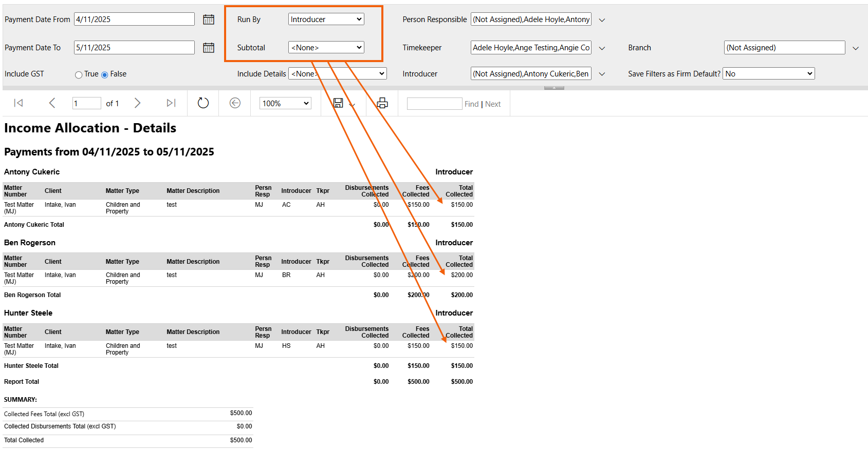

Reporting on Split Introducer Credits
When Split Introducer Credits are enabled on a matter, payments that are applied to invoices on that matter will show the split on the Income Allocation - Summary and Income Allocation - Details report when Introducer is selected in the Run By or Subtotal filters.
