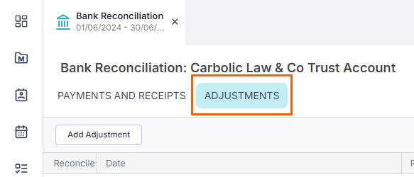

To create an adjustment for a transaction entered in a previous month:
  1. Open the Adjustments tab in the most recent bank reconciliation.
  2. Select Add Adjustment.
  3. Enter the date as the actual date of the transaction (in the example above, this is 30 June).
  4. Enter the amount.
  5. Enter the reason as 'received 30 June but receipted 1 July' (or your own words to that effect).
  6. Select type as Deposit (or if a payment select Withdrawal).
  7. Save & Return to the Reconciliation tab.
  8. Note that the Adjustment amount has been added to the Reconciliation figures and, so long as the rest of your transactions are correct, you can now reconcile.
  9. When you next reconcile, you will need to return to the Adjustments tab and check the Reconcile box next to the adjustment to clear it and reconcile.

To create an adjustment for unknown debits and credits:
  1. Open the Adjustment tab in the most recent bank reconciliation.
  3. Enter the date of the transaction as it appears in the bank statement.
  5. Enter the reason for this item not being entered into a ledger
  6. Select type as Deposit for an unknown credit amount, or Withdrawal for an unknown debit amount.
  9. When you next reconcile, return to the Adjustments tab and check the Reconcile box next to the adjustment.
  10. Return to the Payments and Receipts tab and check off the same adjustment there. Then the transactions should have cleared and you can reconcile this account.
