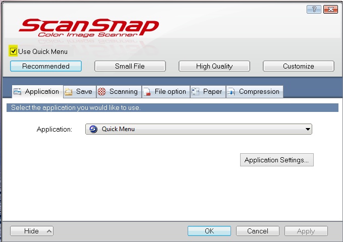

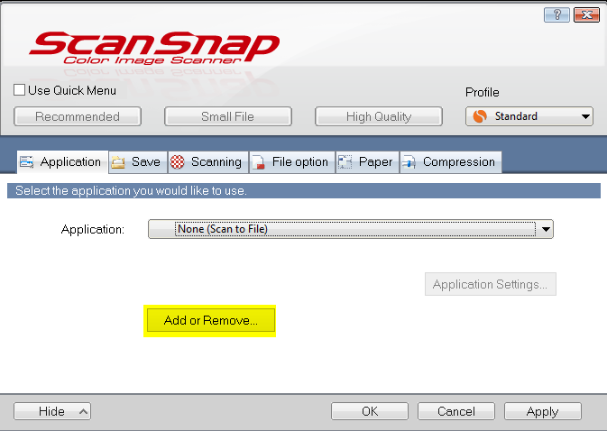

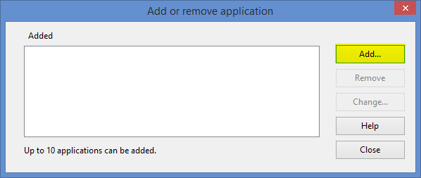

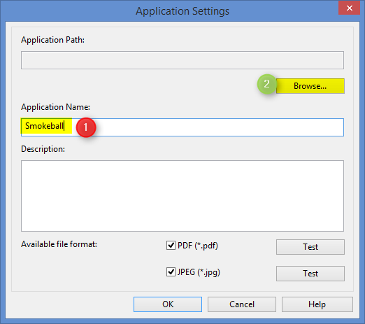

  6. Type "Smokeball" into the Application Name field. Then click the Browse button.scansnap 5.png

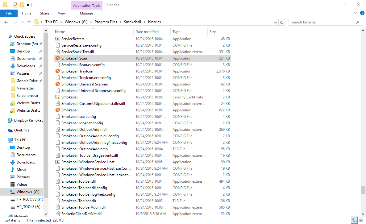

  7. Navigate to C:\Program Files\Smokeball\binaries and double-click on Smokeball Scan.scansnap 6.png

  10. Check the box next to Use Quick Menu.
  11. Click Apply.
  12. Click OK.
