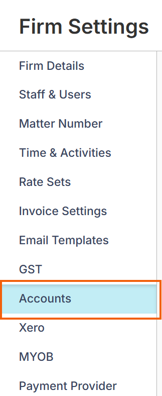

  1. Select the Settings icon on the bottom-left corner of the Smokeball Web App, then select Firm Settings.
  2. Click on AccountsĀ from the left menu.

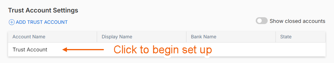

  3. In theĀ Trust & CMA SettingsĀ tab, a Trust Account placeholder has been set up for you. Click on the Trust Account to rename this and add your trust account details.

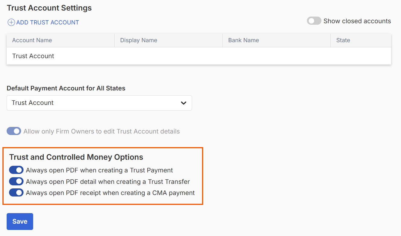

  4. It is recommended that you toggle on all the settings under theĀ Trust and Controlled Money Options to readily view, print and email PDFs of any trust transaction made.

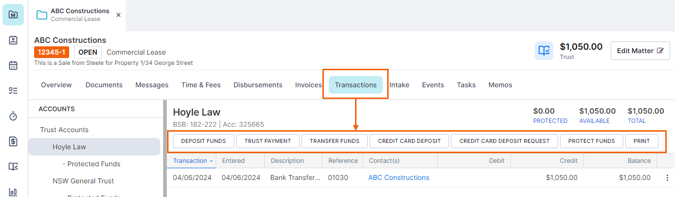

In Smokeball, trust transactions are handled from within a client's matter file. To get started:
  1. Open a matter in the Smokeball Web App.
  2. Select theĀ Transactions tab.
  3. On the left panel, click on your trust account.
The blue buttons underneath the trust account name and number are all the trust transaction actions you can take. We will go through each option in sequence.

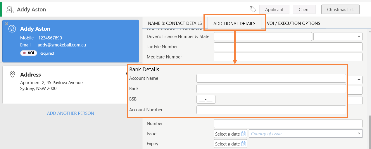

    • If you select Bank Transfer and select Direct Deposit as the transfer type, you will be asked to enter the account name, number and BSB. To save time from entering these details every time, you can open the contact in the Smokeball desktop app and add their bank details there.Ā

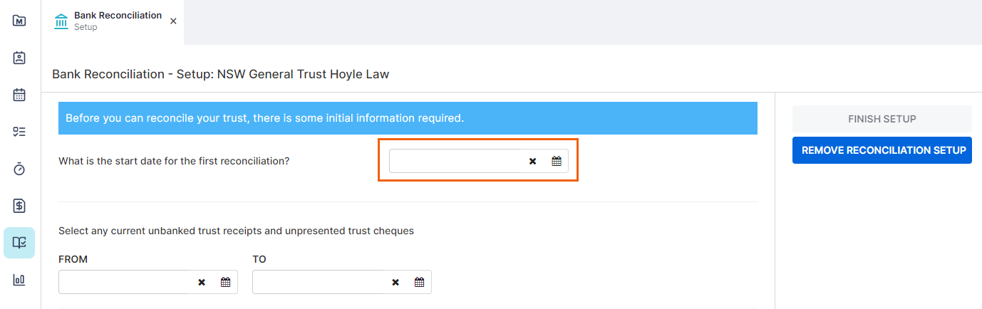

Setting up your first reconciliation in Smokeball
If you have a new, fresh trust account with no pre-existing balance, you will be prompted to Setup Reconciliation. Follow the steps to enter a start date for the first reconciliation (usually the first day of the month you are reconciling) and select any unbanked trust transactions or unpresented cheques.
If you have a trust account with an existing balance, get in touch with our Training Team to book a Trust Transition session. Once you have completed that session, you can follow the rest of the article.
