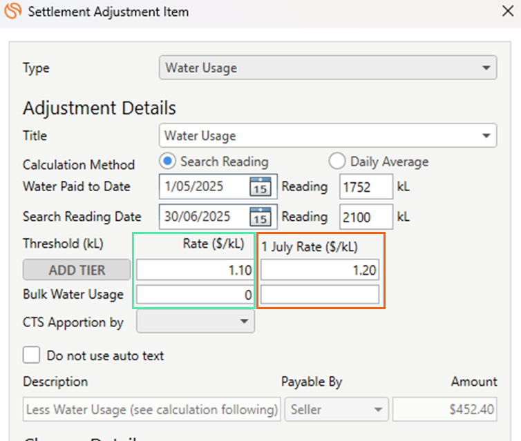

Water Usage overlapping Financial Years
When Water Usage Paid To Date and Adjustment/Settlement Date overlap the end of a Financial Year and the beginning of another, you can enter the different rates in the Rate ($/kL) and the 1 July Rate ($/kL) columns.
In this situation, you would use the:
  • Rate ($/kL) column for the Water Paid To Financial Year’s rate; and the
  • 1 July Rate ($/kL) column to enter the Adjustment Date Financial Year’s rate.

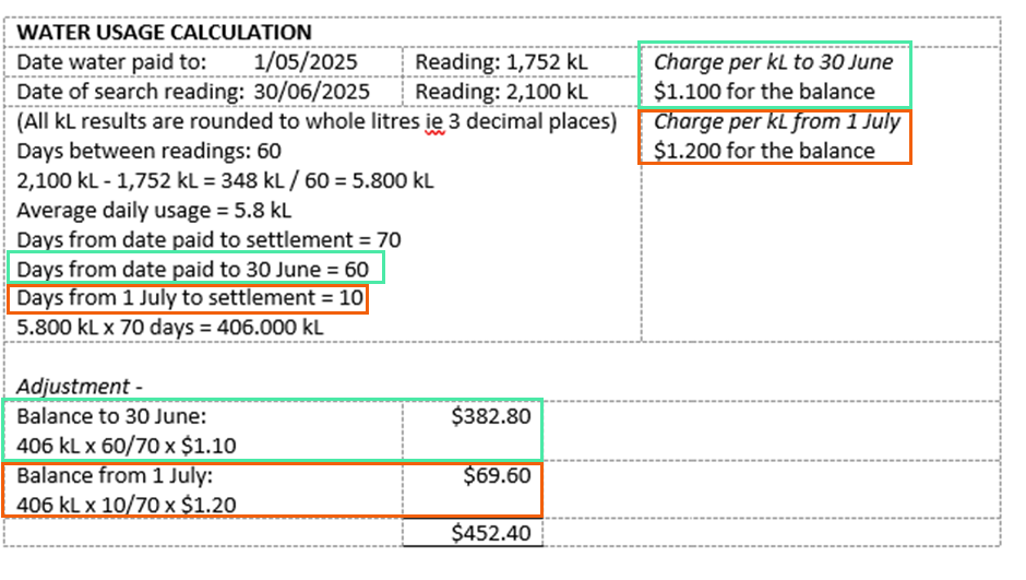

For example:
  • Water Paid To is 1/5/2025 and it falls in the FY24/25 and the rate is $1.10/kL.
  • Adjustment Date is in the subsequent Financial year FY25/26 and the rate is $1.20/kL.
This will then calculate each Tier up to the end of the first financial year i.e. FY24/25, and then from the beginning of the second financial year i.e. FY25/26 to the Adjustment date like so:
This applies only where the Water Paid To date and the Adjustment Date fall in successive Financial Years i.e. one immediately following the other (e.g. 24/25 and 25/26) and are at the cross over period.
