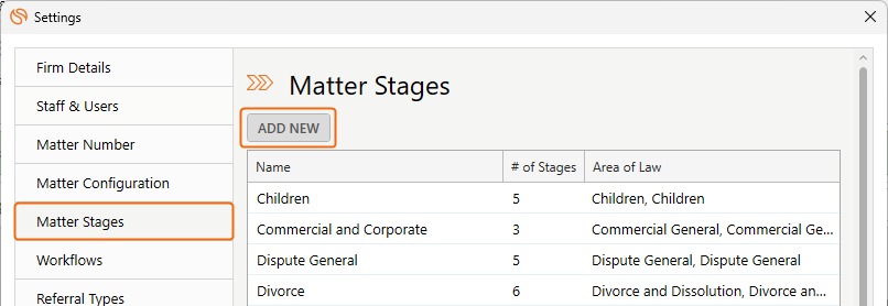

To set up Matter Stages for various matter types, navigate to Smokeball Settings and click on the Matter Stages tab.
Existing Matter Stage Sets will be shown and can be amended by double-clicking. Otherwise, click the Add New button to begin a new list.

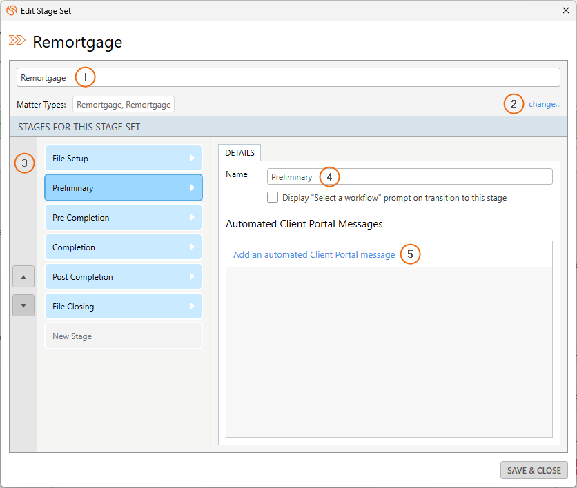

Fill in the following information:
  1. Name of the Stage Set
  2. The Matter Type the Stage Set will apply to. You can create multiple Stage Sets for the same Matter Type. You will be able to choose which Set to use on each new matter of this type. You can also select multiple Matter Types for the same Stage Set.
  3. Start adding stages and click New Stage to enter another. Individual stages can be moved up or down the order by the arrow buttons.
  4. Each stage only requires a Name to be entered.

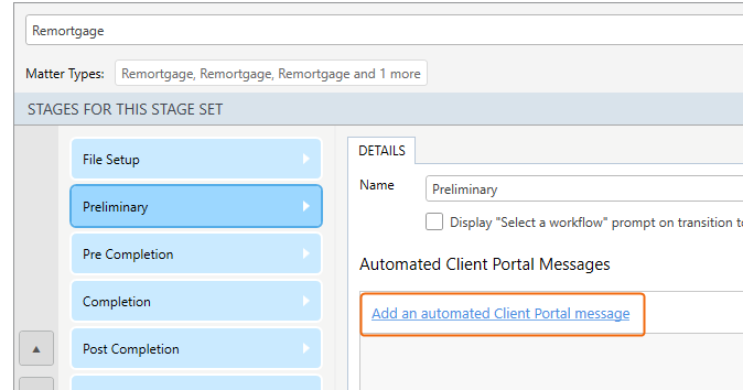

  5. You can also choose to add an automated Client Portal Message to be sent when the new stage is reached for the first time on each matter.

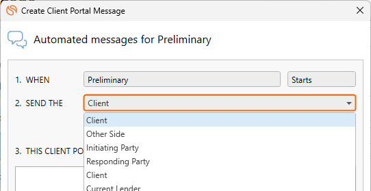

Add a Client Portal message to a matter stage
You may wish to have an automated Client Portal message fired off to staff members or clients when the matter moves to the next stage. To set this up:
  1. Select Add an automated Client Portal message.
  2. Choose who the Client Portal message will be sent to from the drop-down list.

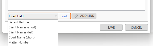

  3. Type your message. Use the Insert Field drop-down list to enter variable fields in the message (e.g. Client Name, Matter Number).
  4. Click Save to return to the Stage Set.
  5. Repeat if you want to set up different messages/recipients for each stage.
