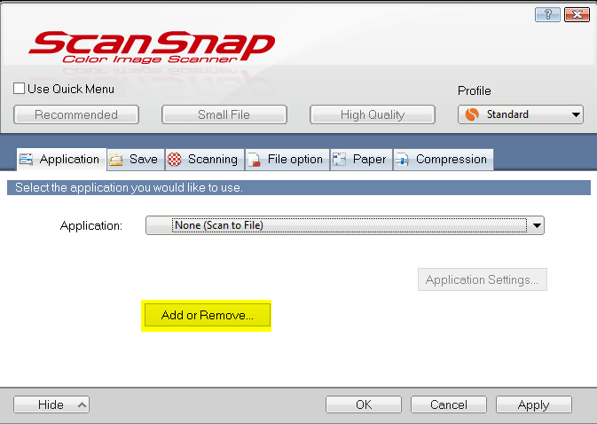

4. Click Add or Remove... button.

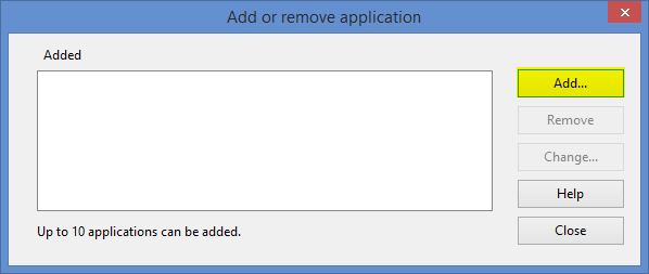

5. Click the Add button.

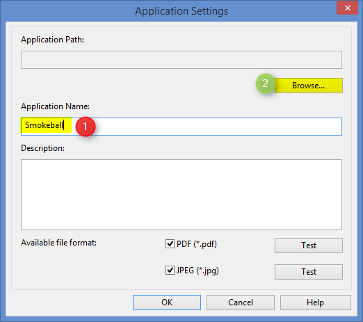

 6. Type "Smokeball" into the Application Name field. Then click the Browse button.

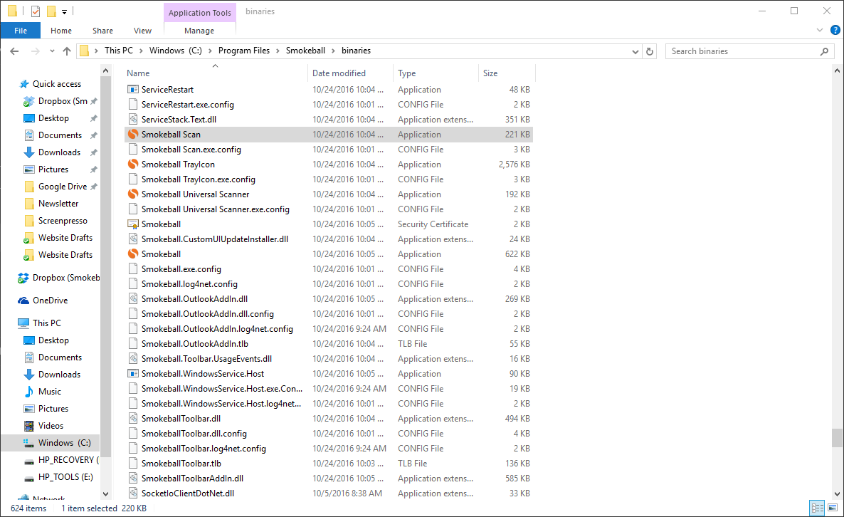

7. Navigate to C:\Program Files\Smokeball\binaries and double-click on Smokeball Scan.

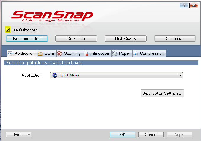

10. Check the box next to Use Quick Menu.
11. Click Apply.
12. Click OK.
