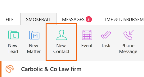

Create a contact in the Smokeball Desktop App

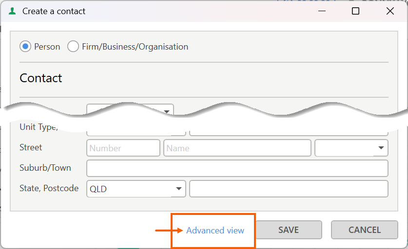

  1. Select New Contact from the Smokeball action bar in the Desktop App.

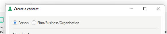

  2. Select whether the contact is for a Person or a Firm/Business/Organisation. The information you need to fill in changes according to what is selected here.
    Note: You cannot change the contact type once it has been created.
  3. Enter information into each field as best you can. The minimum information needed to save a contact is a Given Name.
  4. Select Advanced view to open the contact card.

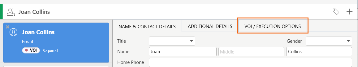

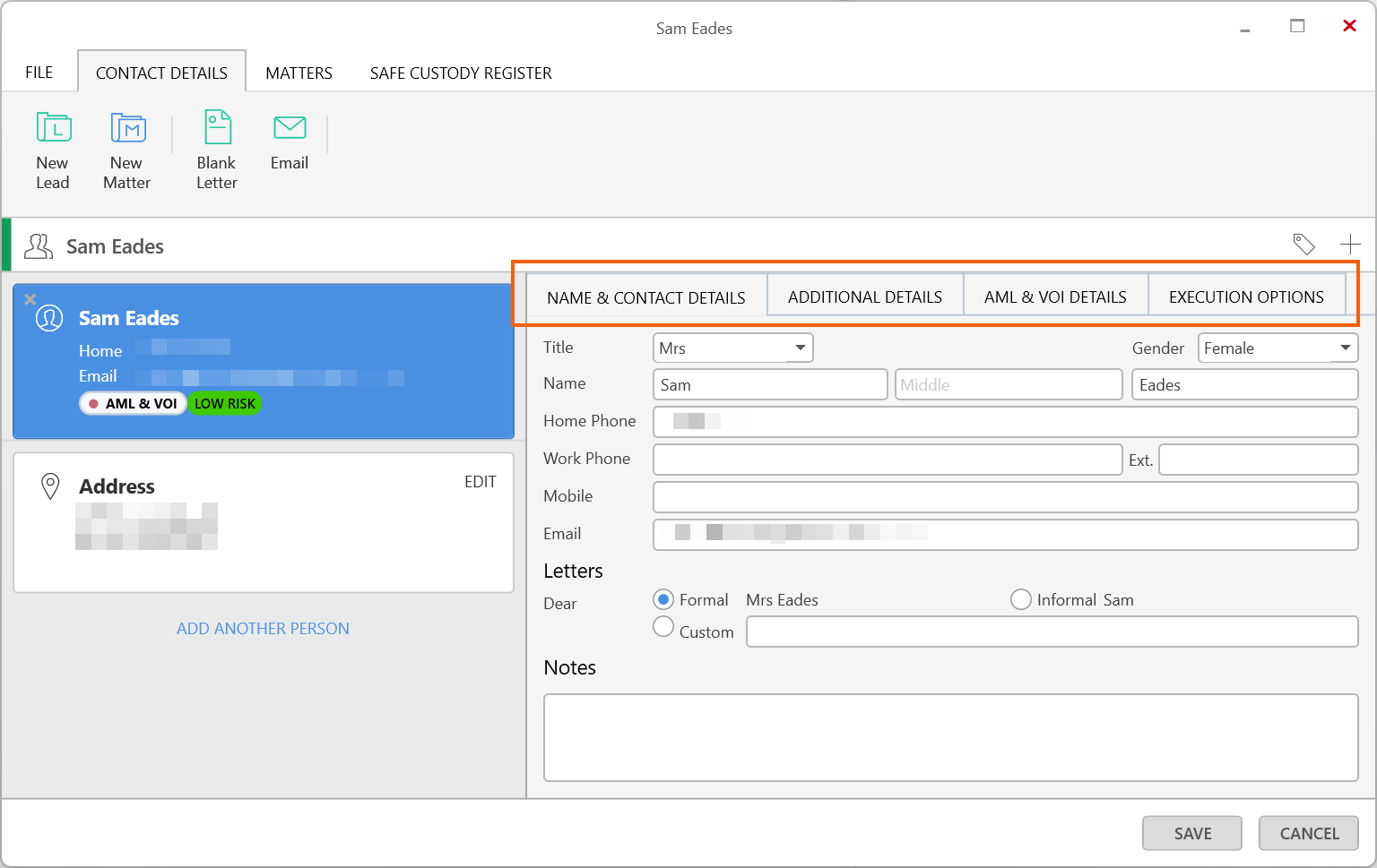

Entering details for an Individual Contact

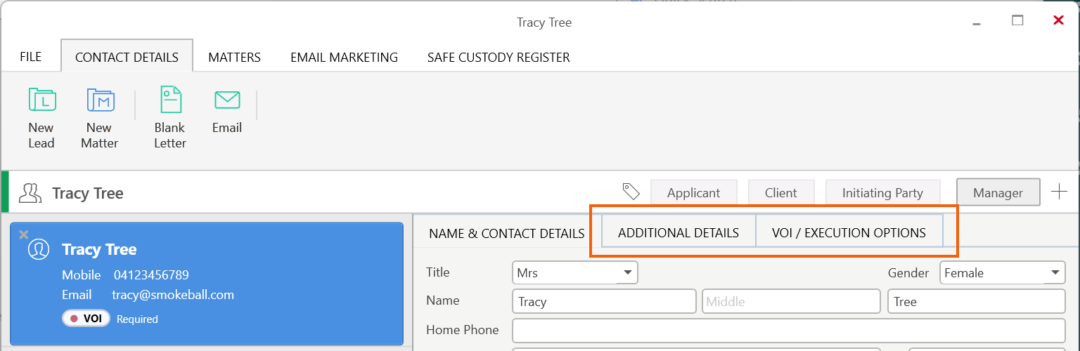

For Individual contact cards, the Name & Contact Details, Additional Details, AML & VOI Details, and Execution Options tabs are where you will enter all the information for a contact.

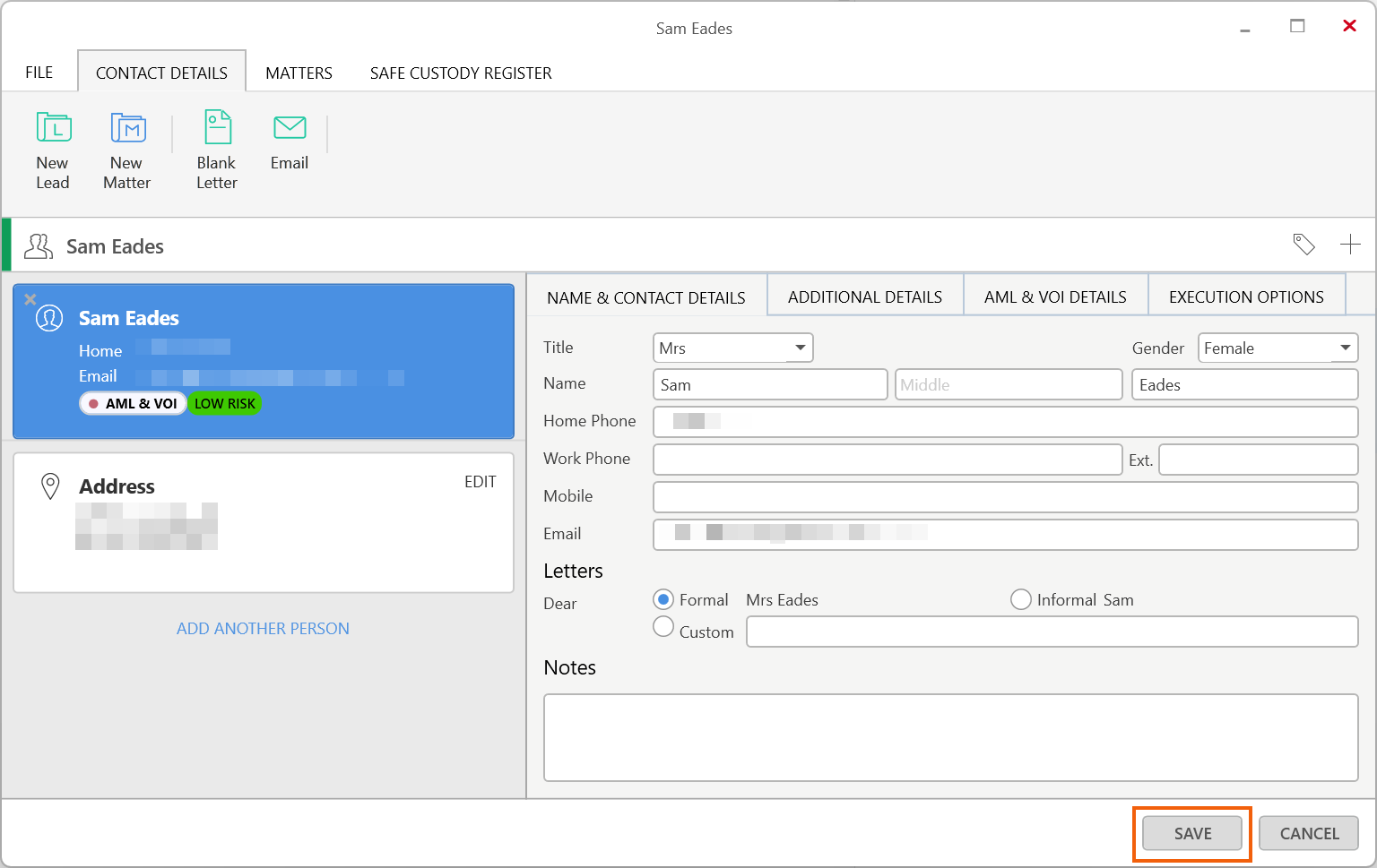

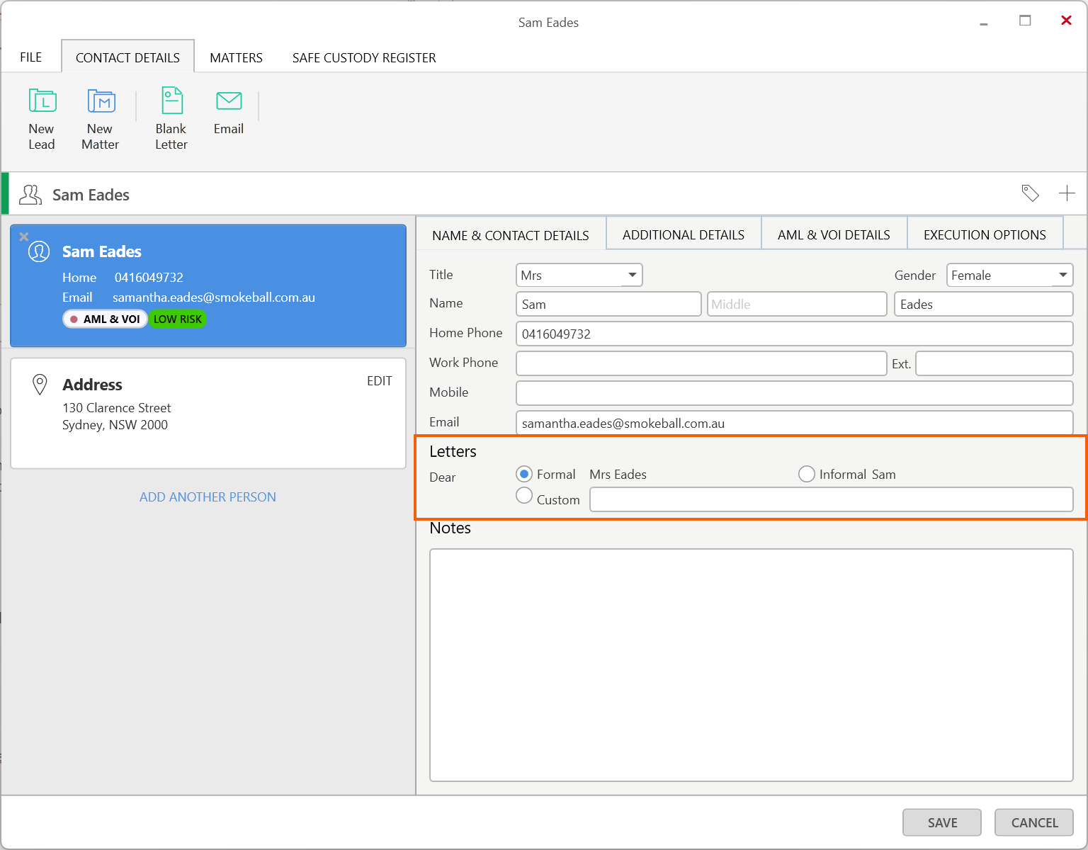

The Name & Contact Details tab is where you enter basic information about the contact's phone numbers and email.
Under the Letters section, you can choose the appropriate salutation for this contact when you send letters to them. The Custom field is where you can enter an alternative name the contact may go by (such as an anglicised name or nickname).
At the bottom of this tab is the Notes section, where you can add information like alternative addresses.

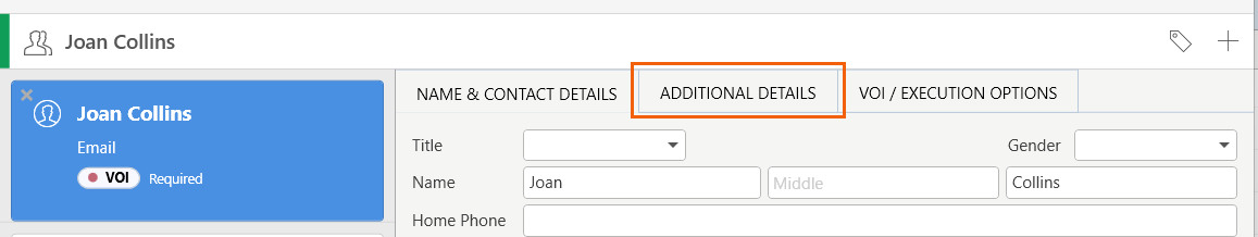

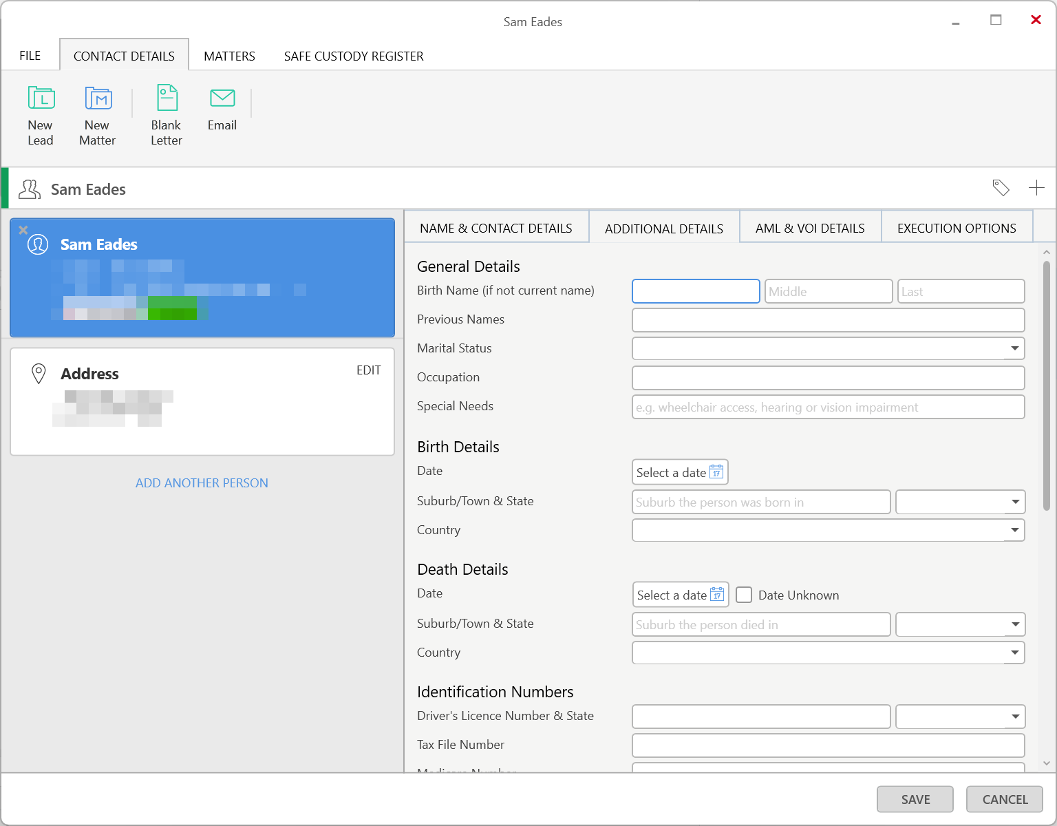

Additional Details
Additional details is where you can add in all other required information for your contacts including:
  • Previous name/ Maiden name
  • Occupation
  • Date of birth (DOB)
  • Date of death
  • Identification numbers such as Licence number
  • Citizenship
  • Passport information
  • Bank account details

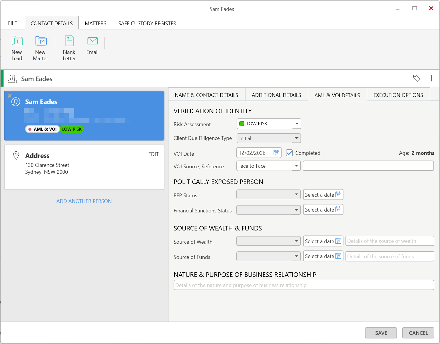

AML & VOI Details
The AML & VOI Details tab is where you enter information regarding the contact's AML status. This is a requirement as per AML/CTF Tranche 2 regulations coming into effect from July 1 2026.

Once you are done entering information in each tab, select Save at the bottom of the window.

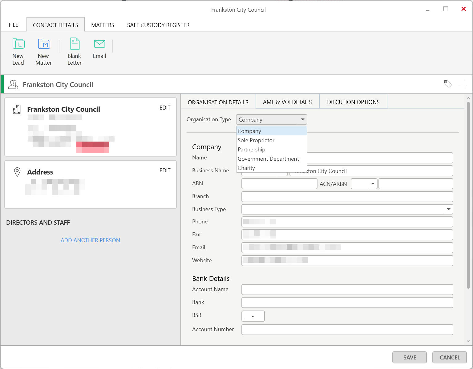

Entering details for a Firm/Business/Organisation Contact

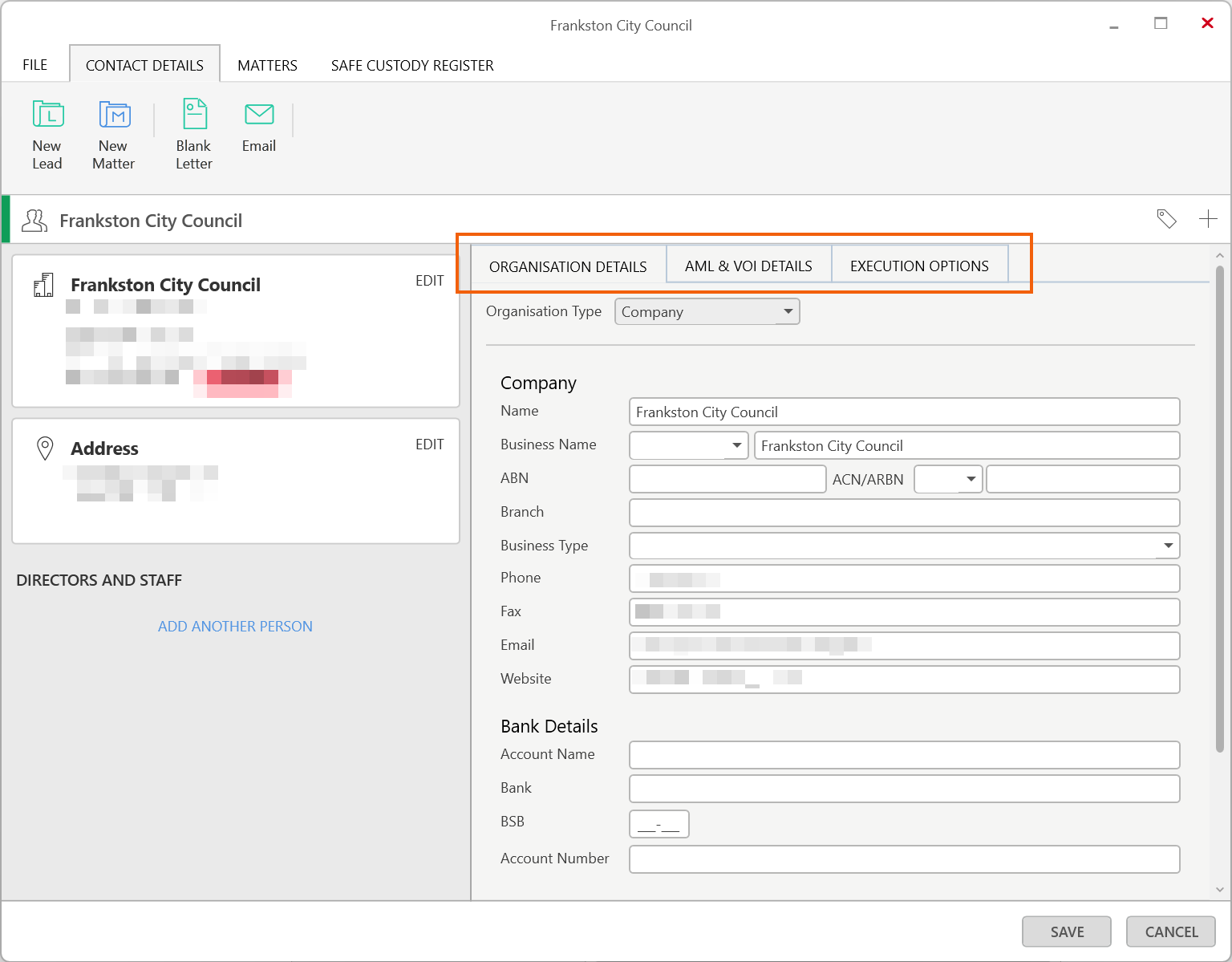

For Organisation contact cards, the tabs available are the Organisation Details, AML & VOI Details, and Execution Options.
Use the Organisation Details tab to enter basic information about the contact, like the Organisation Type and communication and bank details. At the bottom of the tab, you can enter Notes about the contact.

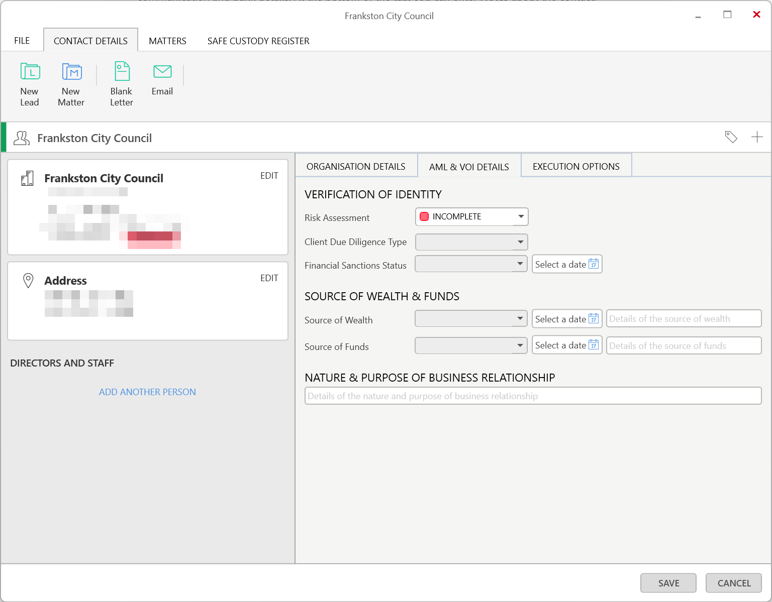

AML & VOI Details
The AML & VOI Details tab is where you enter information regarding the organisation's AML status. This is a requirement as per AML/CTF Tranche 2 regulations coming into effect from July 1 2026.

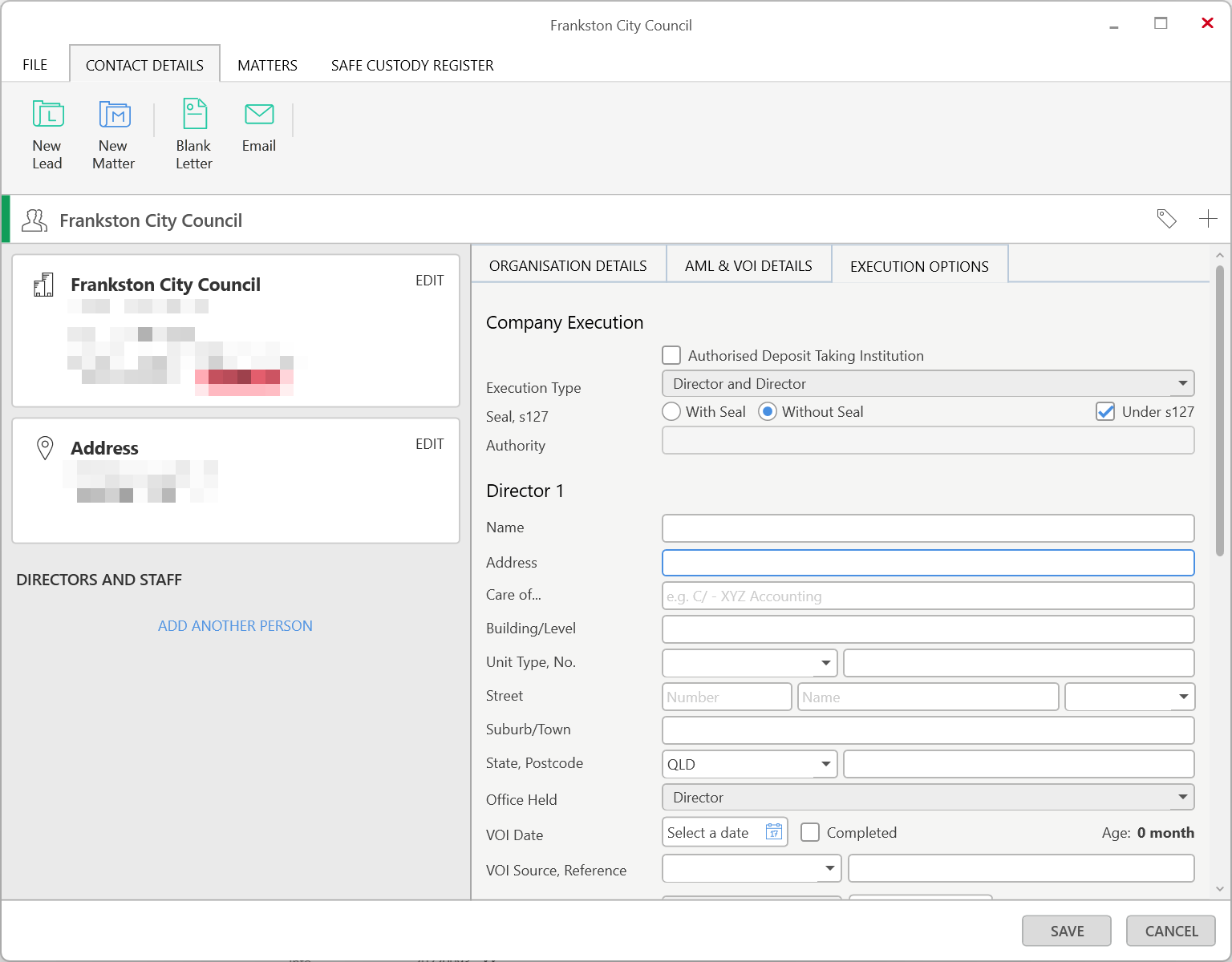

Execution Options
The Execution Options tab is where you enter information about the Company Execution, including the details and AML status of up to 2 directors.

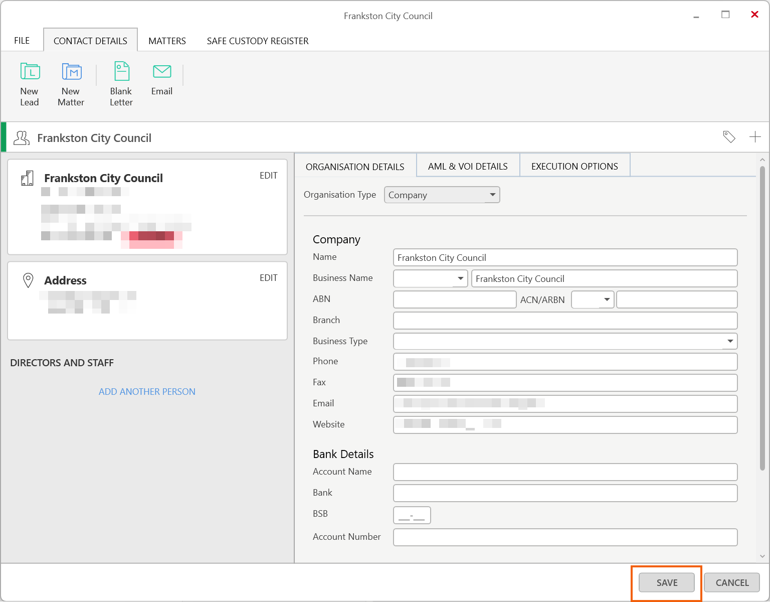

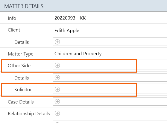

Create a new contact from a matter
When a new matter is created, the Matter Details section contains many fields for entering contacts. The process then involves adding every required contact to the matter.
  1. Select the plus icon to add a new contact.
  2. The New Contact window will now open. Follow the steps above to create the contact.

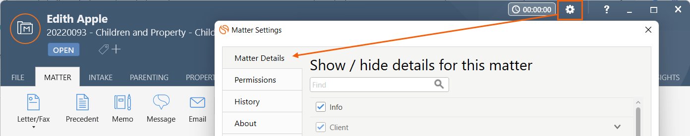

Add a required contact field to a matter
You can add and remove contact fields displayed in a matter by selecting the Settings (gear) icon on the top-right corner of the matter window.

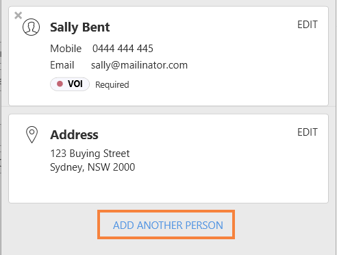

Add another person to the contact card
When you have multiple contacts at the same address, you can add them in:
  1. Click on "Add another person" from within the advanced contact view.
  2. Enter the details for this contact.
  3. Click Save.
Your contacts will then be displayed in the matter details.

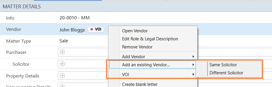

  1. Right-click on the first contact from the matter details screen
  2. Select "Add contact" or "Add existing contact"
  3. Enter the contact details and click Save.

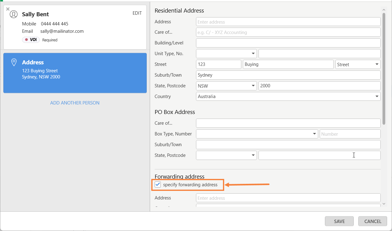

Enter an address or forwarding address
  1. Select the Address box on the left panel to enter the contact's address details.
  2. If you have the forwarding address of a contact, tick specify forwarding address to enter the details.
Letters to this contact will now use the Forwarding address as the mailing address.
When you need to update the forwarding address to the current address:
  1. Un-tick the Forwarding address box.
  2. Select "Yes" to update this to the current address.

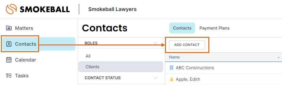

Create a contact in the Smokeball Web App
Note that the additional tabs that are available in the Smokeball Desktop App are not available as fields in the Smokeball Web App.

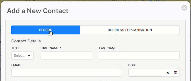

  1. Select Contacts from the left menu in the Smokeball Web App .
  2. Select Add Contact.
  3. Select whether the contact you wish to enter is an individual person, or a business/organisation. Your selection here will change the contact details fields in the rest of the window.
  4. Enter the contact's details.
  5. Select Save.
