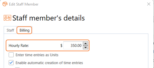

  1. Select the Settings (gear) icon at the top right of Smokeball.
  2. Go to the Staff & Users menu option.
  3. Double-click on the relevant staff member’s name.
  4. Go to the Billing heading.
  5. Input the staff member's hourly rate.
  6. Select Save.

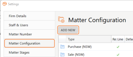

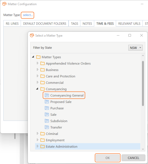

  2. Go to the Matter Configuration menu option and select Add New.
  3. Select the relevant Matter Type, for example, Conveyancing General, then select OK.

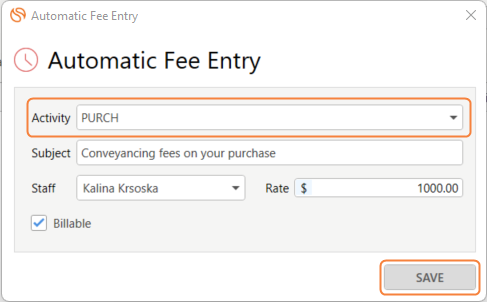

  4. Navigate to the Time & Fees tab. Tick the Automatically create fee entry checkbox and select Add.
  5. Select the previously set up activity code from the drop-down menu. The selected activity will pre-populate the empty fields. Select Save.
