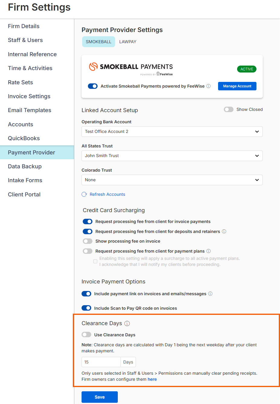

Setting clearance days
By default, clearance days are set to 5 business days. To change this:
  1. Select the Settings (gear) icon on the bottom-left corner of the Smokeball Web App, then select Firm Settings.
  2. Select Payment Provider from the left menu.
  3. Under the Clearance Days section, change the number of days to one that is most relevant for your firm.
  4. Select Save.

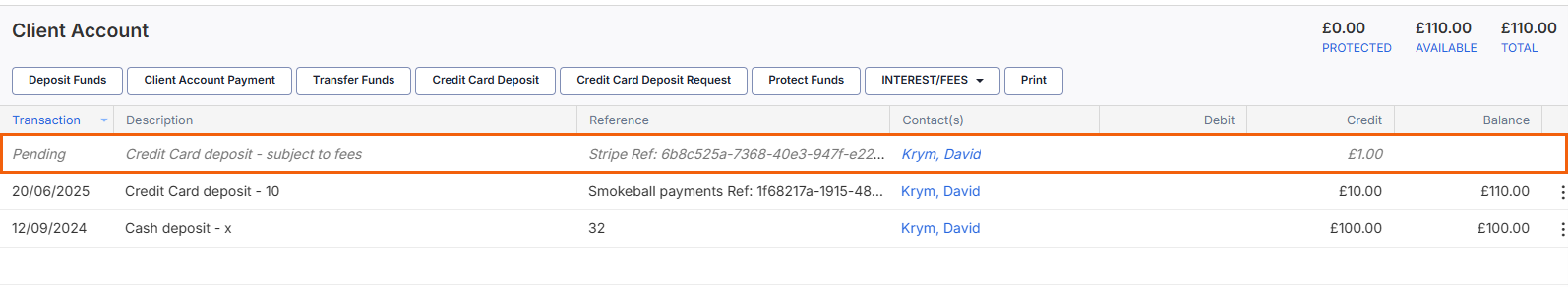

How clearance days appear in Smokeball
When a payment is within the clearance period, it will appear italicised in your list of payments, as shown below:
After the clearance days have passed, the payment will display normally. The Transaction Date will show as the number of clearance days after the date the client made the payment.

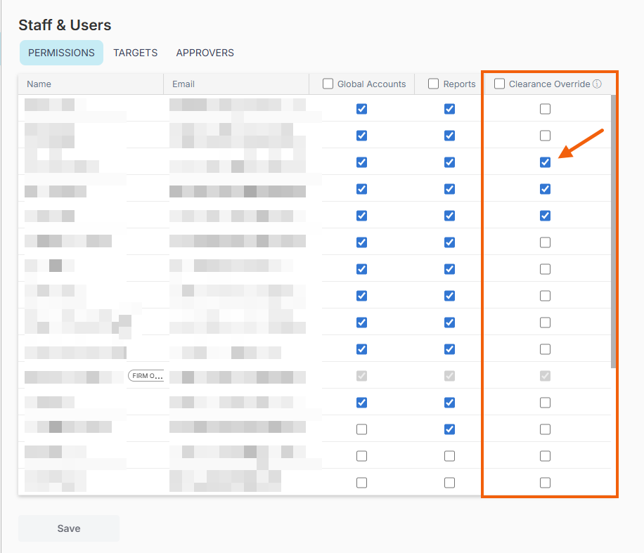

Before you begin
Ensure you or the staff member have the Clearance Override permission enabled. To check or enable this permission:
  2. Select Staff & Users from the left menu.
  3. Find the relevant staff member in the list and tick the Clearance Override box next to their name.
    • Staff members designated as Firm Owners will have this permission automatically enabled.
  4. Select Save.

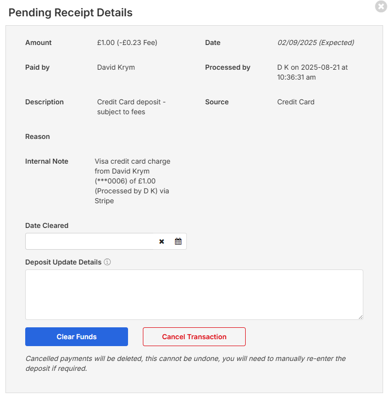

To manually clear a pending payment:
  1. Click on the pending payment.
  2. Enter a Date Cleared, along with notes in the Deposit Update Details.
  3. Select Clear Funds.
