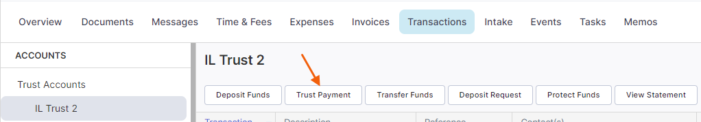

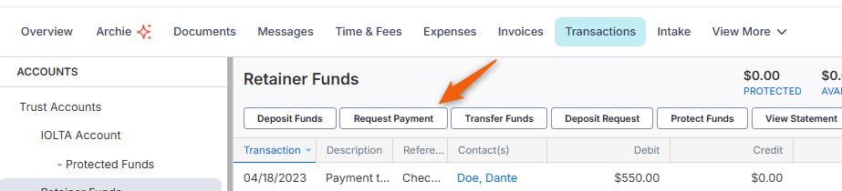

  1. Navigate to the Transactions tab within a matter and select your trust account or operating retainer account.
  2. Select the Trust Payment or Request Payment button (depending on firm settings either will show) or Operating Payment button.

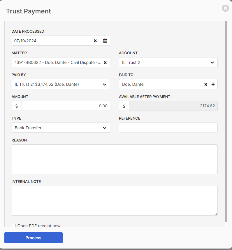

  1. Fill out the amount in the Trust Payment window and select your client in the Paid To window.
    • You can search for existing contacts or clients by typing out their name. Use the + icon if you need to add a new person or organization for the refund.
    • You can also add a reference or an internal note.
    • Trust Payment refunds can be issued as a bank transfer or check depending on your selection in the Type dropdown menu. However, you cannot issue a check from the operating retainer.
  2. When you have finished entering all of the necessary information, select the Process button.

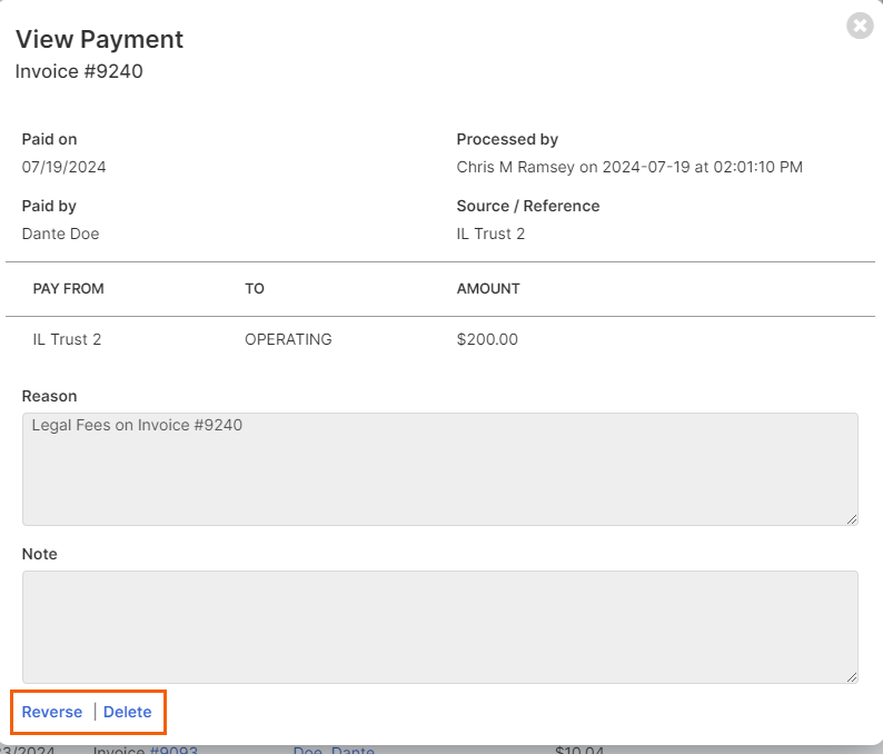

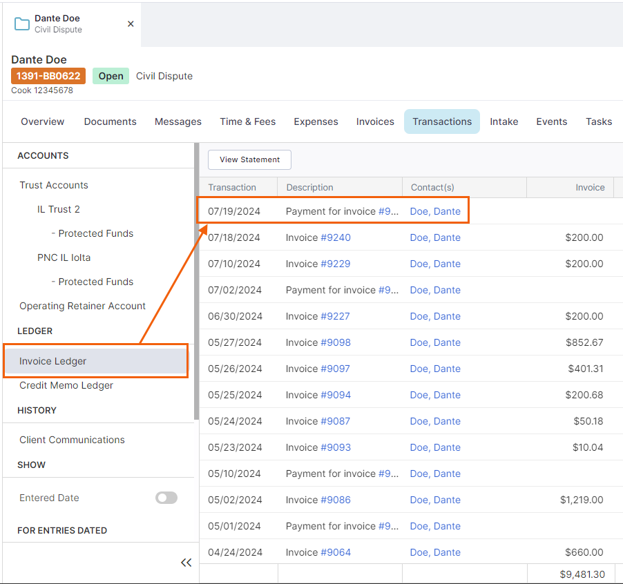

One option is to delete or reverse the payment from an invoice. While on the matter's transactions tab, select Invoice Ledger from the leftmost column for a list of transactions. You then should follow steps described above for refunding a trust or operating retainer transaction to complete the refund.

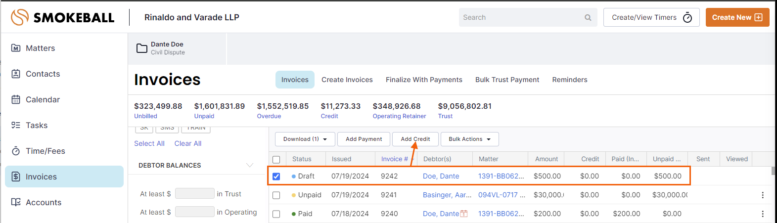

Another option is to apply a credit memo to the next invoice you draft for the client.
