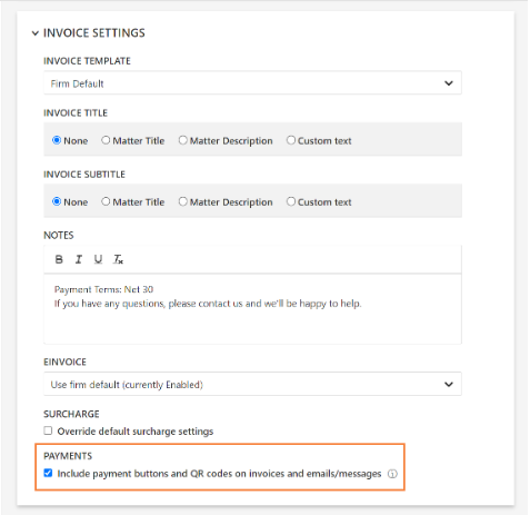

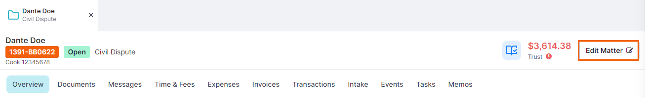

To access the setting:
  1. Open a matter in Smokeball, select Edit Matter, and then select Billing Fees and Rates.
  2. Scroll down to the Invoice Settings heading and then de-select Include payment buttons and QR codes on invoices and emails/messages.
The Pay Now link and QR code do not appear on the invoice.
