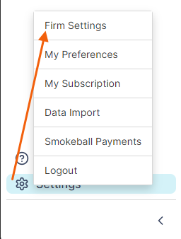

  1. Select the Settings icon on the bottom-left corner of the Smokeball Web App, then select Firm Settings.
  2. Click on Accounts from the left menu and navigate to the Trust Account Settings tab. By default, there should already be a Trust Account on this page for you to modify. Click on the Trust Account to edit it with a trust account name/display name of your preference, the state, and bank name.

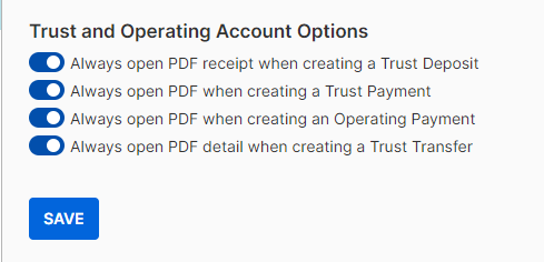

  5. Optional: You can toggle on all the settings under the Trust and Operating Account Options to readily view, print and email PDFs of any trust transaction made.

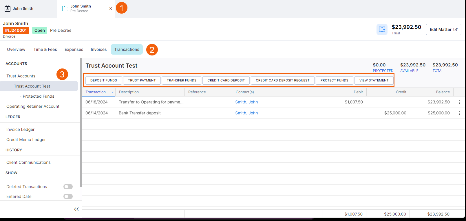

In Smokeball, trust transactions are handled from within a client's matter. You will need to follow these three steps to make any trust transaction:
  1. Open a matter in the Smokeball Web App.
  2. Select the Transactions tab.
  3. On the left panel, click on your trust account.
The buttons underneath the trust account name and number are all the trust transaction actions you can take. We will explain each of these buttons in sequence.

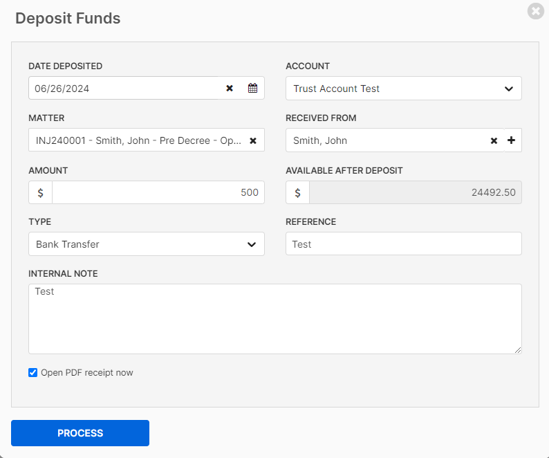

Deposit funds
Use this button to record a client deposit:
  1. Click on Deposit Funds.
  2. A window will display on the screen, with the default date set to today's date. You can edit this date to reflect backdated deposits. Make sure the date field is correct: an incorrect date will affect your bank reconciliation (especially if the deposit occurred at the beginning or end of a month).
  1. By default, the client's name on the matter will be populated in the Received From field. Select the X icon to replace them with an existing contact, or select the + icon to replace them with a new contact.
  2. Enter the amount to deposit, the payment method, the reason for depositing and any internal notes.
    • Anything entered into the Reference field will show up on the Trust Receipt PDF.
    • Anything entered as an Internal Note will not show up on the Trust Receipt PDF.
    • Both the Reason and Internal Note can be viewed when clicking on the deposit transaction in the Transactions tab.
  3. Once you are done with recording the deposit, select Process.
  4. Optional: Learn more about depositing funds in trust accounts.

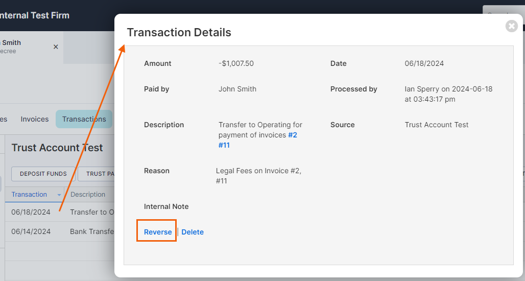

It is very important to make sure all the fields are 100% correct, as you cannot edit trust transactions after they are processed. To rectify any mistakes, you must reverse or delete the transaction. Note: Doing so will affect the reconciliation process.
To make a reversal or deletion, click on the transaction from the Transactions tab then select Reverse or Delete and enter the reason for the reversal or deletion.
All reversals and deletions will be noted in a separate line in the Transactions tab for audit purposes.
Learn more about reversing or deleting transactions.

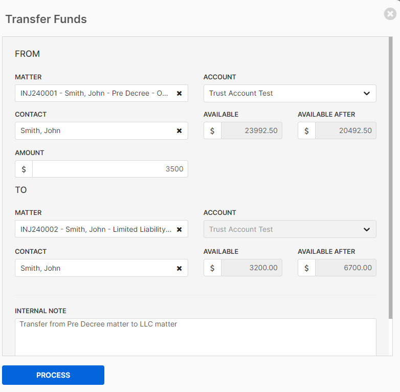

Transfer funds to another matter
For clients with multiple matters who have authorized their funds to be moved between matters, you can create a journal transfer by selecting Transfer Funds.
Even though transfers are money movements between matters, still make sure that all details are correct before processing them.
Learn more about transferring funds to another matter.

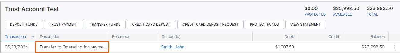

Invoice payments will be transferred to the operating account and entered into the Transactions tab of the matter as Transfer to Operating for payment.

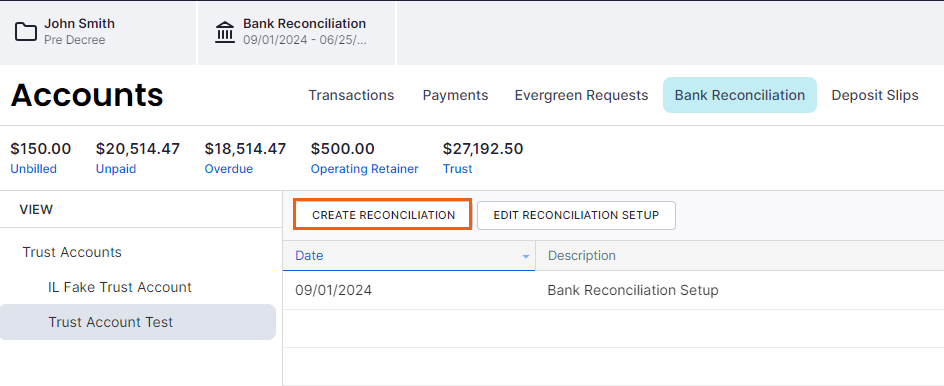

Bank reconciliation
You can reconcile bank accounts in Smokeball on a weekly, monthly, or quarterly basis. Our recommended practice is to reconcile monthly. However, you will need to follow the same setup steps regardless of your preference.

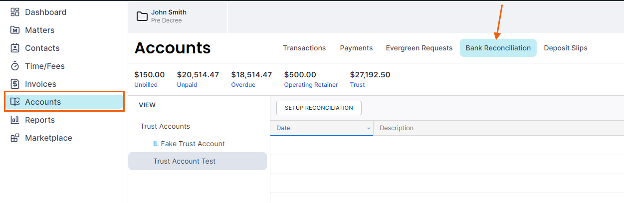

Get started by navigating to the Accounts view from the left menu and then select the Bank Reconciliation tab.

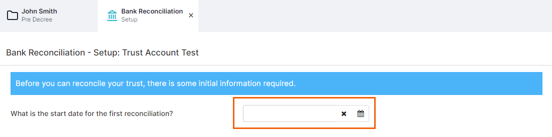

Set up your first reconciliation in Smokeball
If you have a new, fresh trust account with no pre-existing balance, select Setup Reconciliation and enter the start date. If the trust account has no pre-existing balance, you will not need to select any un-banked receipts or unpresented checks.
If you are reconciling a trust account with a pre-existing balance from an old system, you first need to ensure that your clients’ trust funds have been entered into Smokeball. To do so, select the Create New button in the upper-right corner of the Smokeball web app and select Trust Deposit. Note: You can also deposit funds into the operating retainer by using the Account dropdown menu.
We recommend choosing a deposit date that is the actual date of the deposit or before when you want to run the first bank reconciliation in Smokeball. This ensures that the funds and balances you bring over from the old system will be distinct from any new data that is entered after you begin working with Smokeball.
You will also need to account for un-banked receipts and unrepresented checks. Note: An unpresented check is a check you have written out of trust that has yet to be cashed. They will show as paid out in Smokeball, but they will not appear on a bank statement since they have yet to be cashed by the payee. An un-banked receipt refers to deposits that show in Smokeball but have yet to clear the bank. For example, if you deposit a trust check on June 30, but it does not clear the bank until July, you must withhold that deposit for a later reconciliation after it clears the bank.
If you still have questions about how to bring over an existing client balance or managing unpresented checks and un-banked receipts, please submit a support ticket. Otherwise, proceed to the next section below.
Completing a trust reconciliation
To start reconciling:
  1. Select Create Reconciliation from the Bank Reconciliation tab.
  2. Enter the end date of the month or period in the field on the right-hand panel and enter the closing balance of your trust account bank statement in the Bank Statement Balance field.
    • E.g. if your bank statement is for the period March 1 to March 31, enter the closing date as March 31 and the balance at the bottom of the bank statement as of March 31.
  3. Now your goal is to make sure the list of transactions in the Payments and Receipts tab matches the transactions in your trust account's bank statement.
    • Use the tick boxes next to each transaction to tick as you go when comparing transactions to your bank statement.
    • Reversed transactions will also show on this list. You will need to select the toggle if you want to see deleted transactions. Make sure you have ticked both the original transaction and its reversal so that the transactions cancel themselves out.
  4. Ideally, the Reconciliation Balance figure is shown in blue with a $0.00 difference.
  5. Finalize by selecting Reconcile.

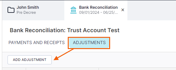

    1. Select the Adjustments tab and Add Adjustment.
    2. Enter the date of the adjustment and the amount.
    3. Select Withdrawal to add this amount as a debit, or Deposit to add this amount as a Credit.
    4. Select Add.

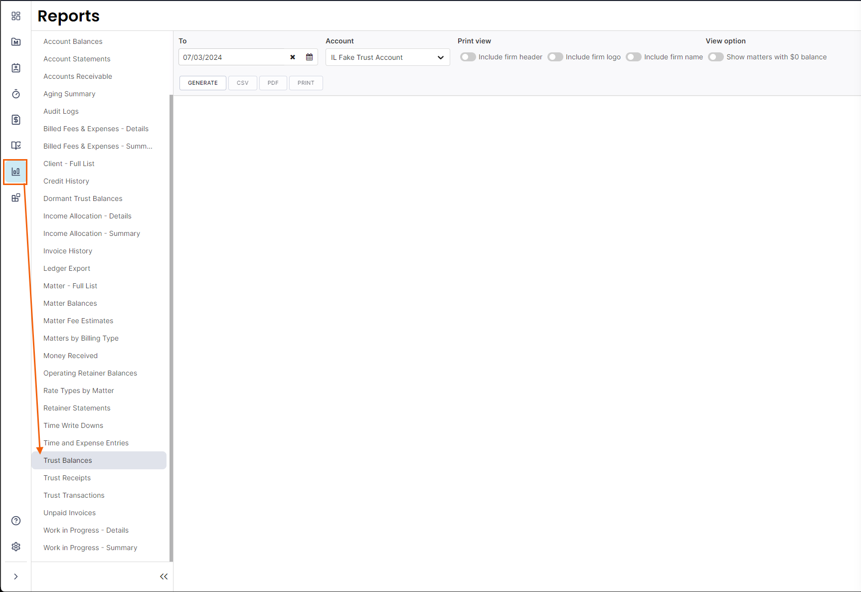

You can run the Trust Balances Report to verify that you have brought over existing client balances successfully.
