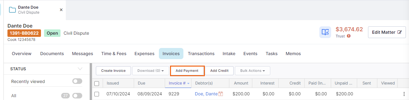

How to Apply a Payment to Multiple Invoices on a Matter
  • Navigate to the Invoices tab in your matter and then select Add Payment.
    • Note: All outstanding invoices will be under Unpaid and Overdue, but these filters do not need to be selected in order to add a payment.

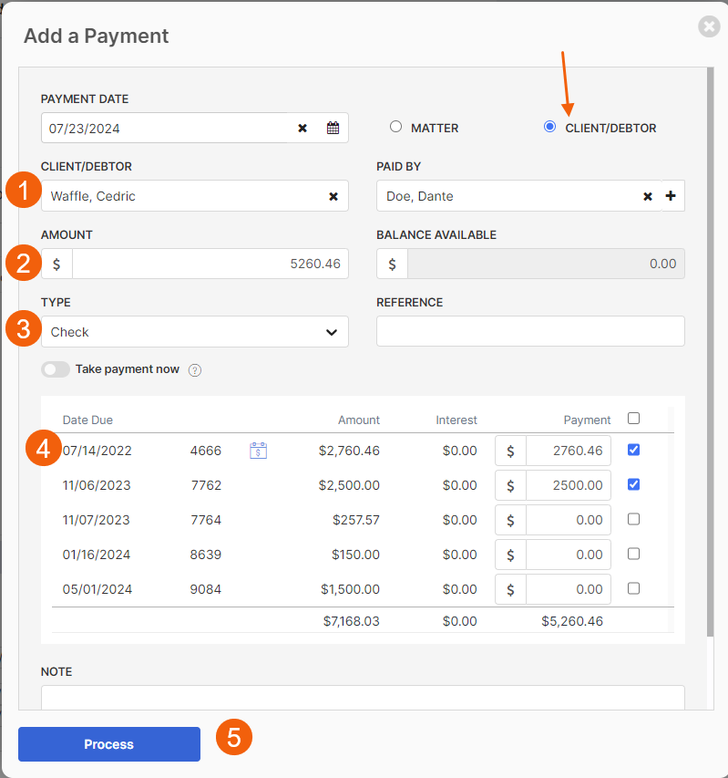

How to Apply a Payment to Multiple Invoices on a Debtor

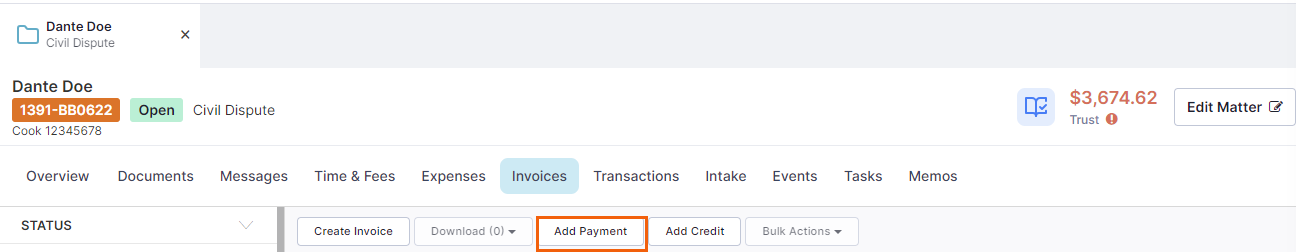

  • Navigate to the Invoices tab on your matter and then select Add Payment.
Follow these steps to add the payment:
  1. Select Client/Debtor and confirm the client/debtor the paying contact.
  2. Enter the total Amount paid.
  3. Choose the type of payment from the Type dropdown menu.
  4. Choose which individual outstanding invoices to allocate payments to.
  5. Select Process.
    • Note: If there are different debtors assigned to invoices on a matter, only the invoices assigned to this debtor will show with this payment screen.

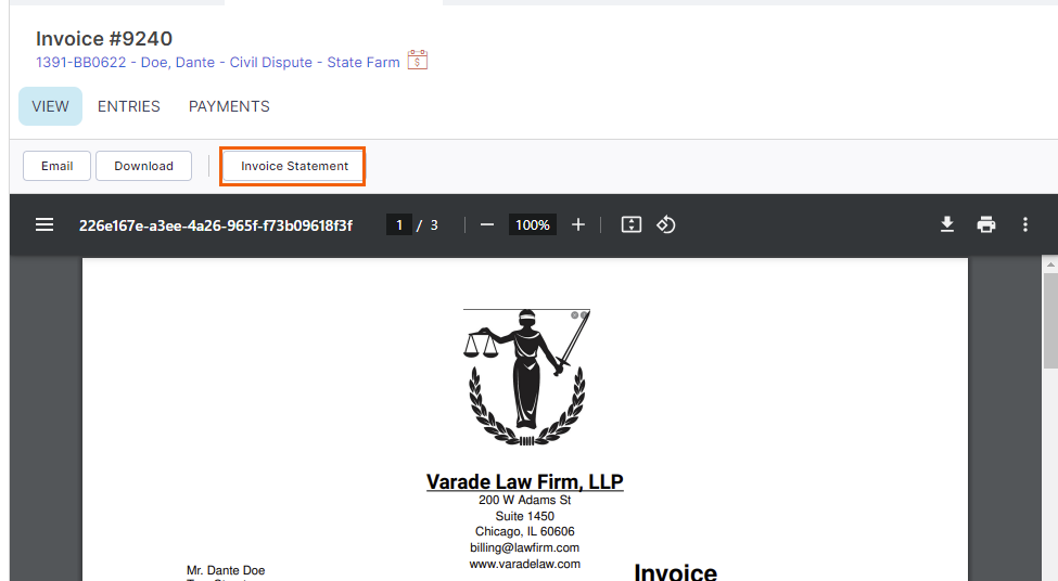

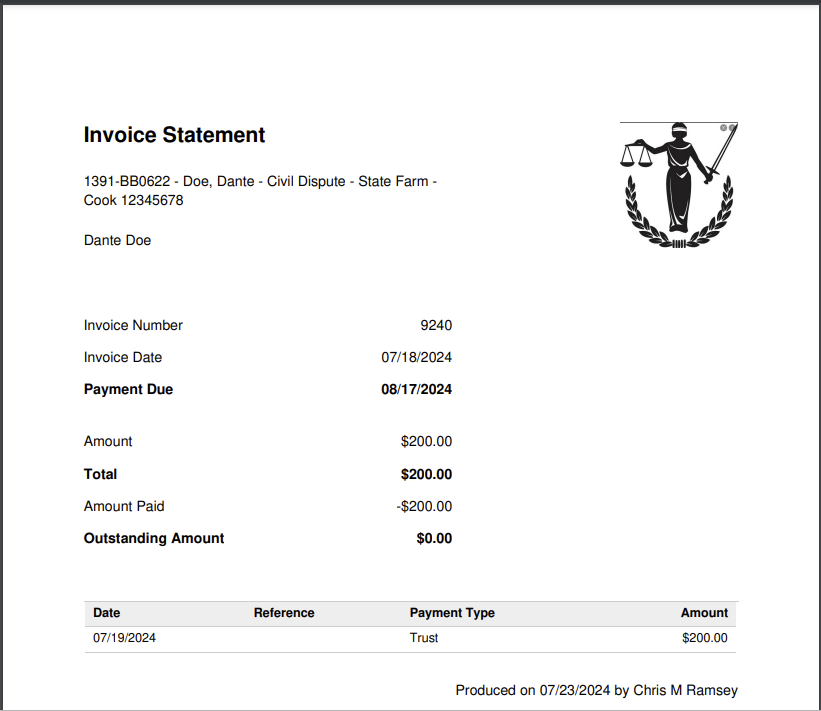

Generate an Invoice Payment Receipt (Payment Detail)
Once an invoice is paid, you can provide a receipt.
  1. Open the invoice from the global Invoices page.
  2. Select the Payment Detail button to generate a payment receipt for that invoice.
  3. The Payment Detail will appear in a new tab. The receipt will show all payments applied to the invoice.

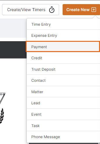

  • The option to add a payment to multiple invoices is also found by selecting the Create New button on the top right of the web app and then selecting Payment.
  • You can also use the Add Payment button on the global invoices screen.
    • Note: You will have to fill out the Matter or Debtor and Paid By fields if using either of these options.
