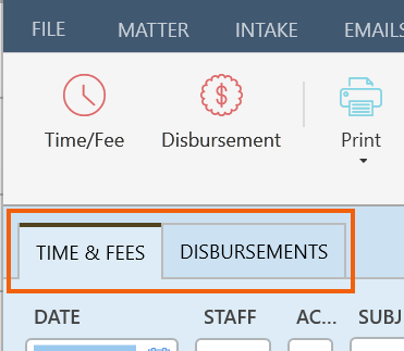

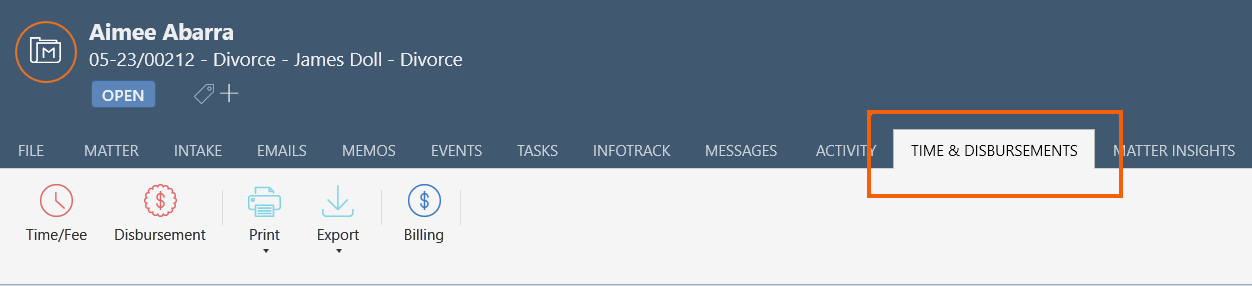

  1. Open the relevant matter, then select the Time & Disbursements tab.
  2. Select the Time & Fees or Disbursements tab.

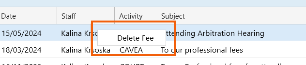

  3. Right-click on the entry and select Delete Fee.
  4. Confirm the deletion when prompted. This will remove the fee or activity entry from the matter.

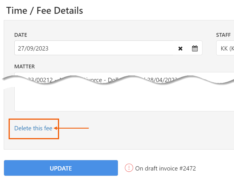

Delete a fee or activity entry on the Smokeball Web App

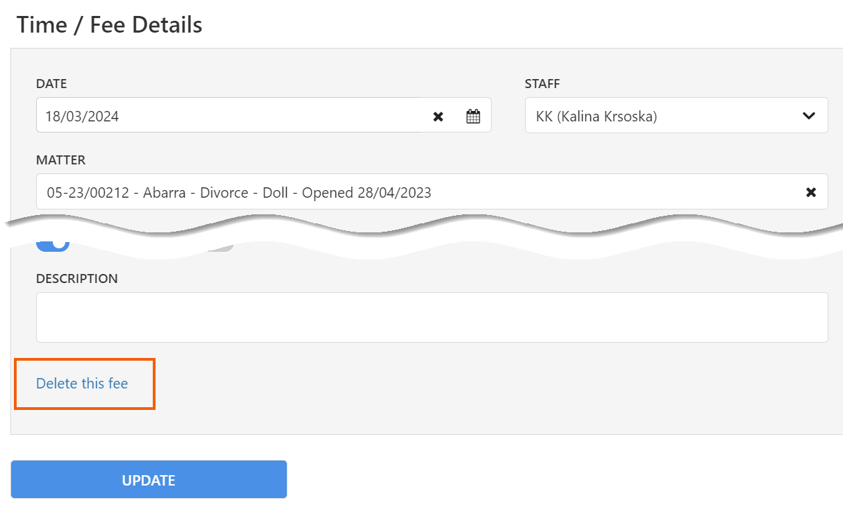

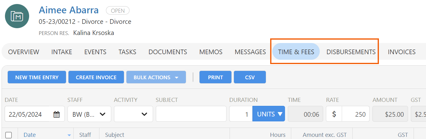

  1. Open the relevant matter, then select the Time & Fees or Disbursements tab, depending on the entry you're deleting.
  2. Click on the entry from the list and select Delete this fee/Delete this disbursement.

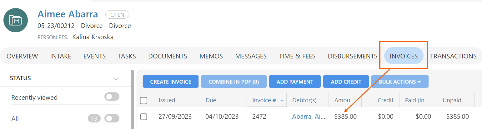

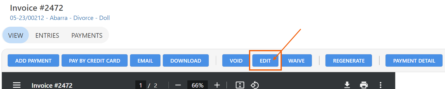

  1. From the Smokeball Web App, open the matter and select the Invoices tab.
  2. Click on the relevant invoice.

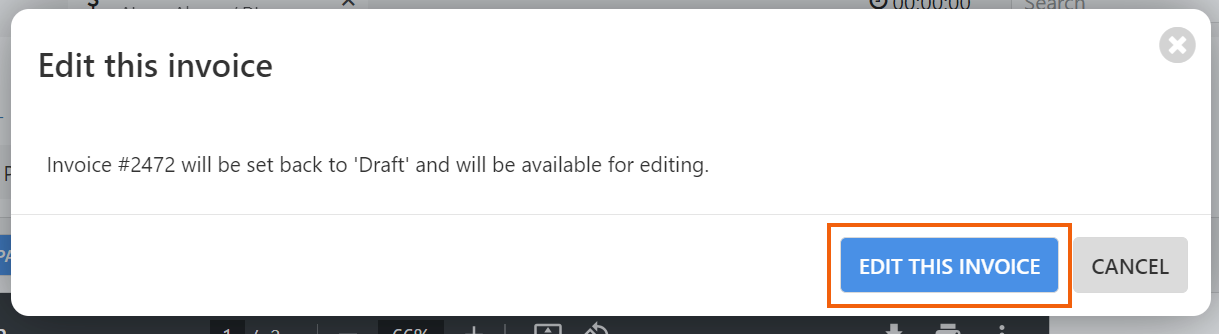

  3. Select Edit above the invoice preview.
  4. Confirm that you wish to edit the invoice.

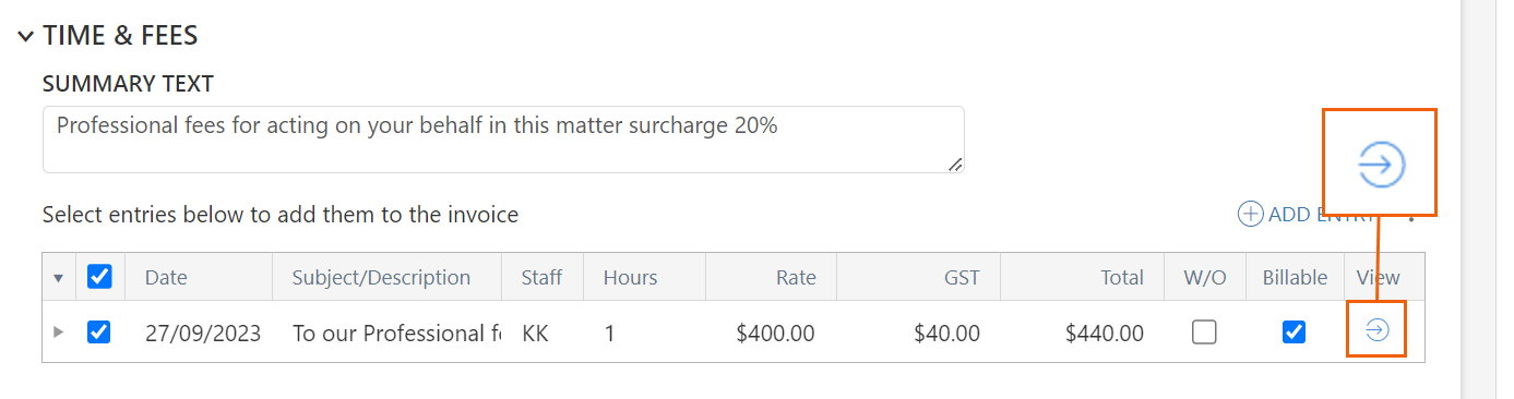

  5. Locate the fee or activity entry under the invoice details.
  6. To open the entry, click on the View icon.
  7. Select Delete this fee/Delete this disbursement.
